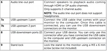

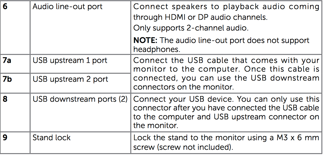

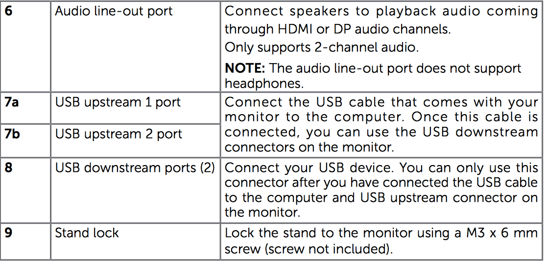

From what I am reading in the manual you need to connect a USB cable from your computer to the upstream port in the monitor to use the down stream ports in the side and back.
Definitely helpful I appreciate it
