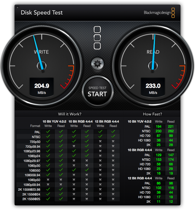

Just curious, have you ever used the Blackmagic speed test to see what your transfer rate is?

Of course ... 🙂
This is a OWC Qx2 RAID-5 with 4 1TB older drives using the Seagate Portable Thunderbolt Adapter (GoFlex) connected to the eSATA port via a SATA-to-eSATA cable:
Note that these results are very similar to the same box connected directly via eSATA to my Mac Pro. This is the first generation of the Qx2 with older WD black 1TB drives. With a 2011 MacMini, this is the fastest interface I have available when using the Qx2.
