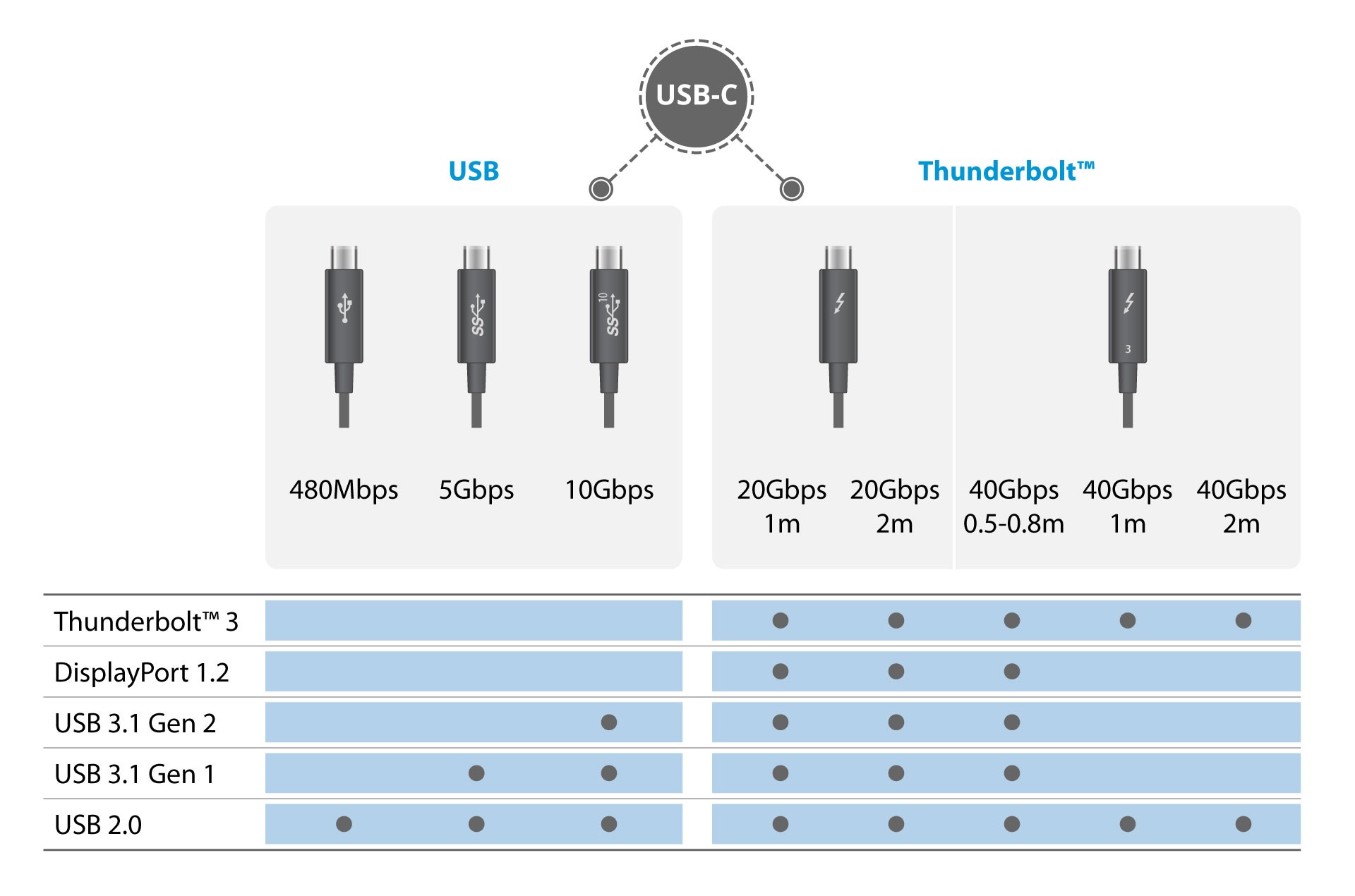

The whole USB-C spec is complete mess, throw Thunderbolt into the picture and it makes it worse. Unless a USB-C cable is properly labelled you don't know what you are getting? Is it a charging cable? Is it a power delivery cable? Is it a USB-C 3.x or USB-C 4 cable?
I have yet to see one place where I can see all the differences between USB-C and Thunderbolt and all the various cabling options in one place. You get bits a pieces from different sources. No wonder why a lot are confused including me at times.
For cables, keep this image handy. Unfortunately it doesn't include TB4, but basically those are "do all" cables. TB4 would be on the far right, and have dots in each box, for all lengths.
