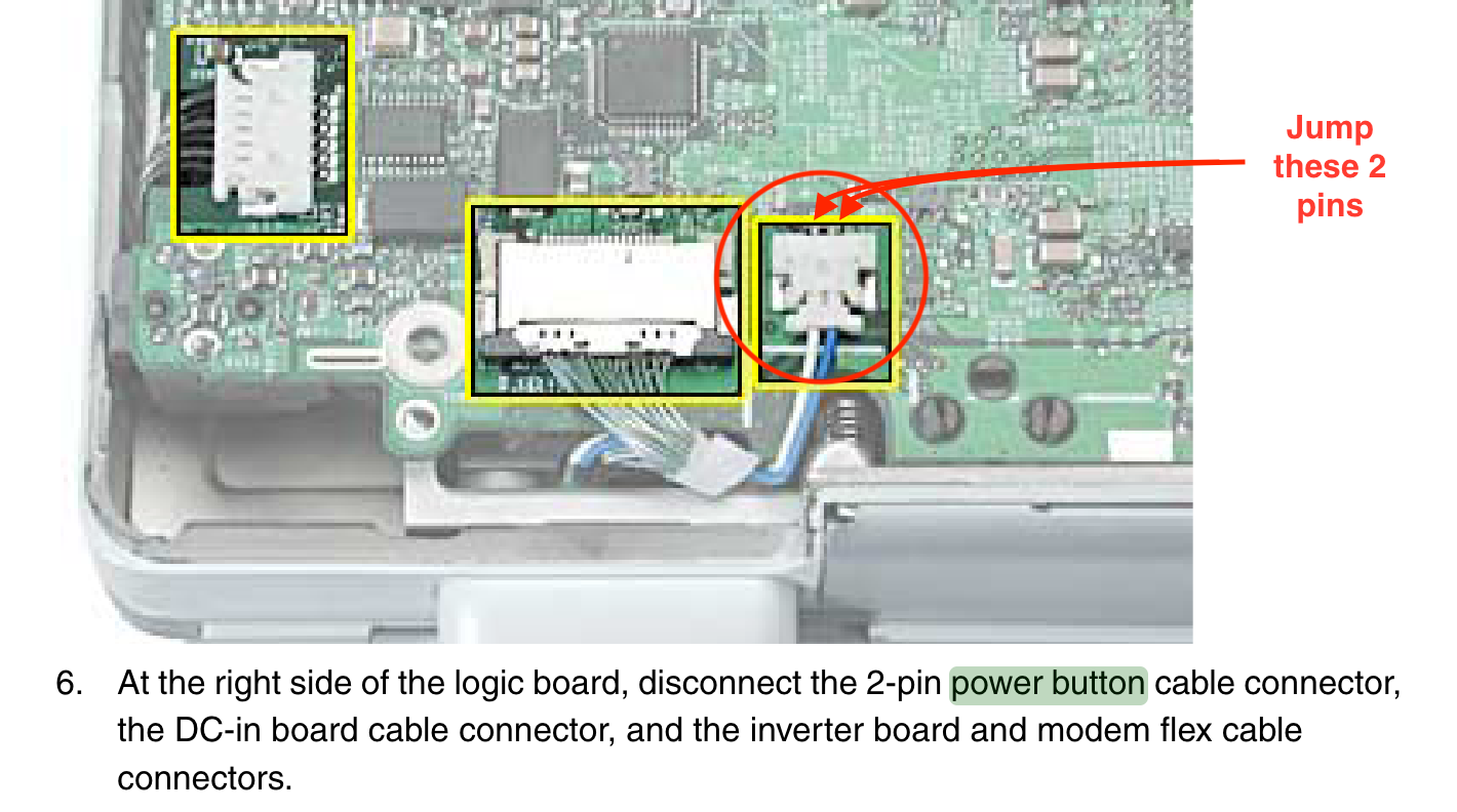

I've also seen the power buttons on these units just stop working (as with some Power Mac G4s) and have had luck booting via jumping the pins on the back of the power button connector on the logic board to determine a faulty button.
These are the pins to jump with a flat head screwdriver or similar - be careful not to short anything else 🙂

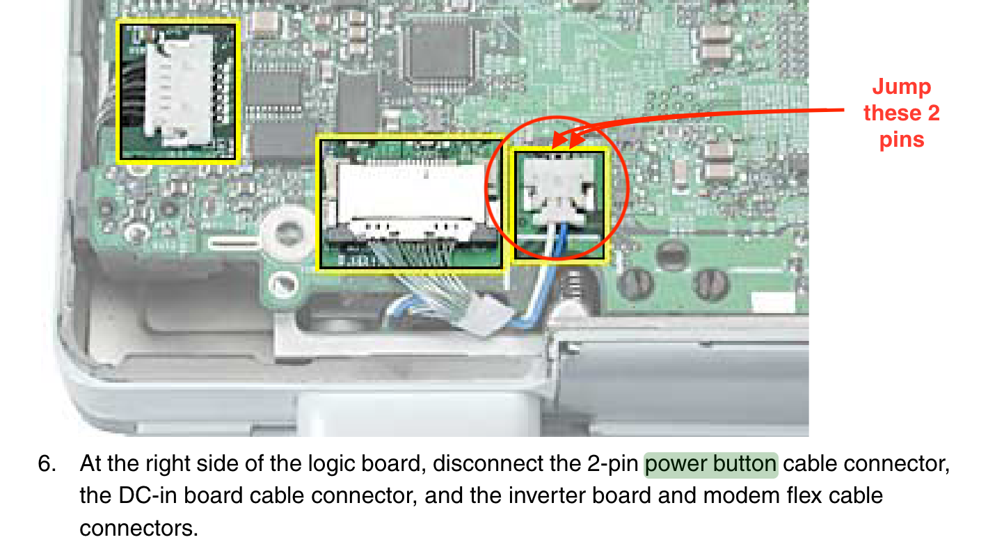

If I'm going to jump it, do I just set my screwdriver on the two pins?
Reactions: AphoticD
Yep, briefly closing the circuit by touching the two posts with a screwdriver will do it
