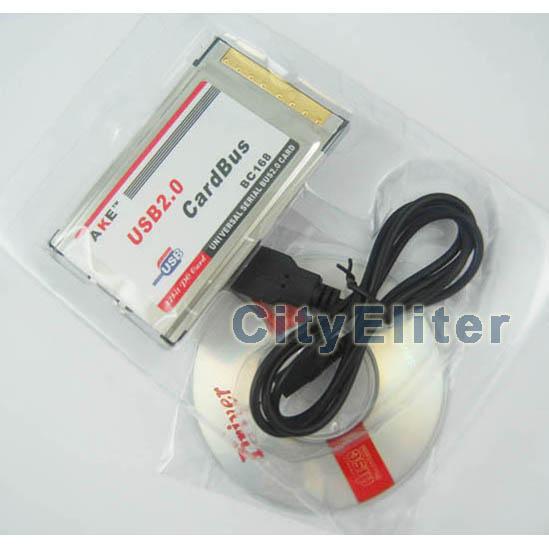

I don't know if you're interested or not, but I got this PC card in Dec. 2011. It's got two USB 2.0 ports and it works in my A1013 without any issues or driver installs.
So, my USB1.1 only 17" PowerBook actually has 4 USB ports. 2/1.1 and 2/2.0
It should work in a TiBook. it's recessed, so the form factor aligns with the outside of the case (nothing sticking out.
