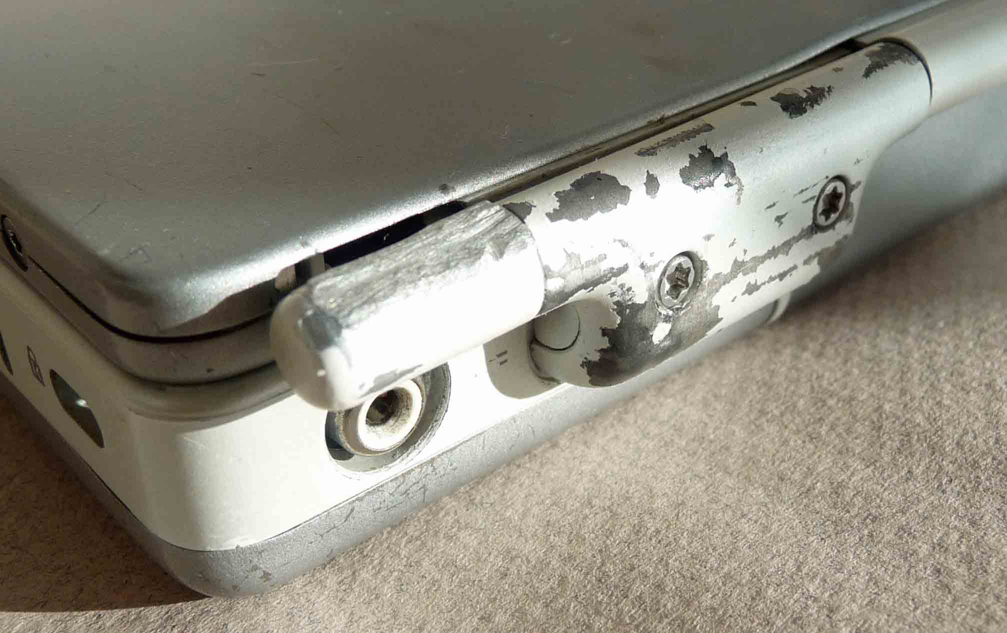

This I find interesting, as I've been wanting to touch-up the hinge covers on my TiBook. I purchased a small spray can, the cap-colour (Ref: Light Grey USAF) seemed to be a perfect match put against the computer. I hope to find time to perform this within a day or two, and report back. Failing an acceptable colour match, I'll try Honda Frost White.

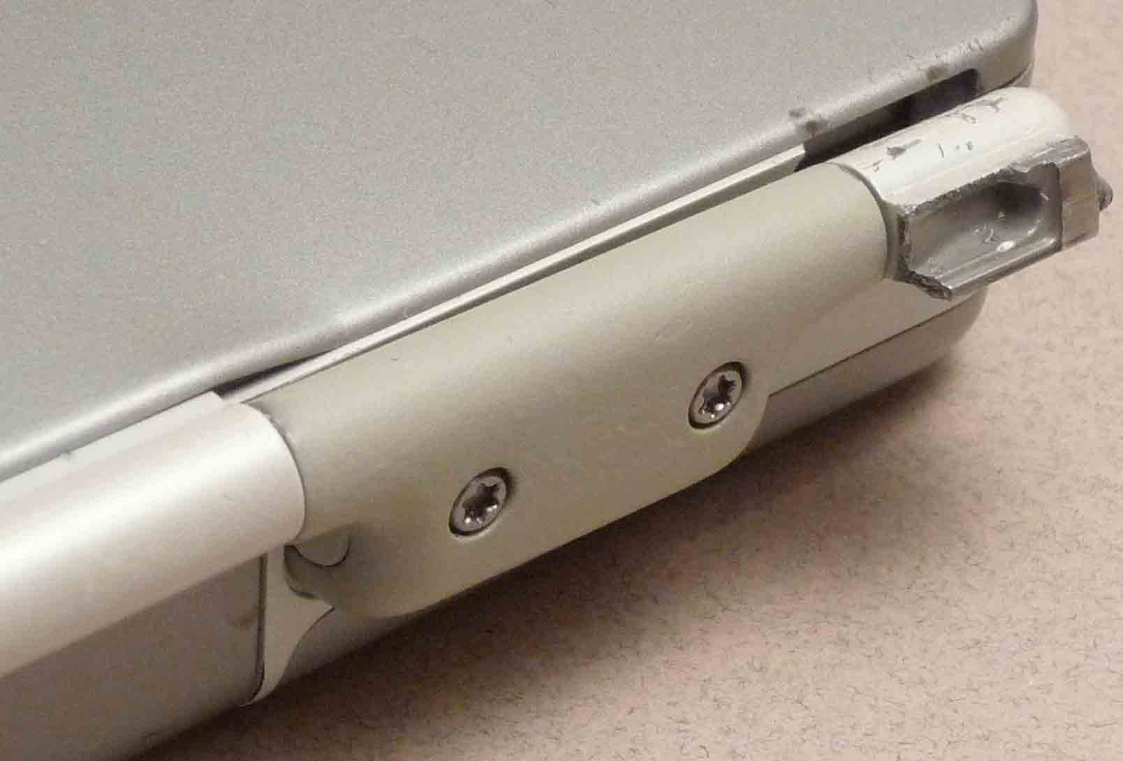

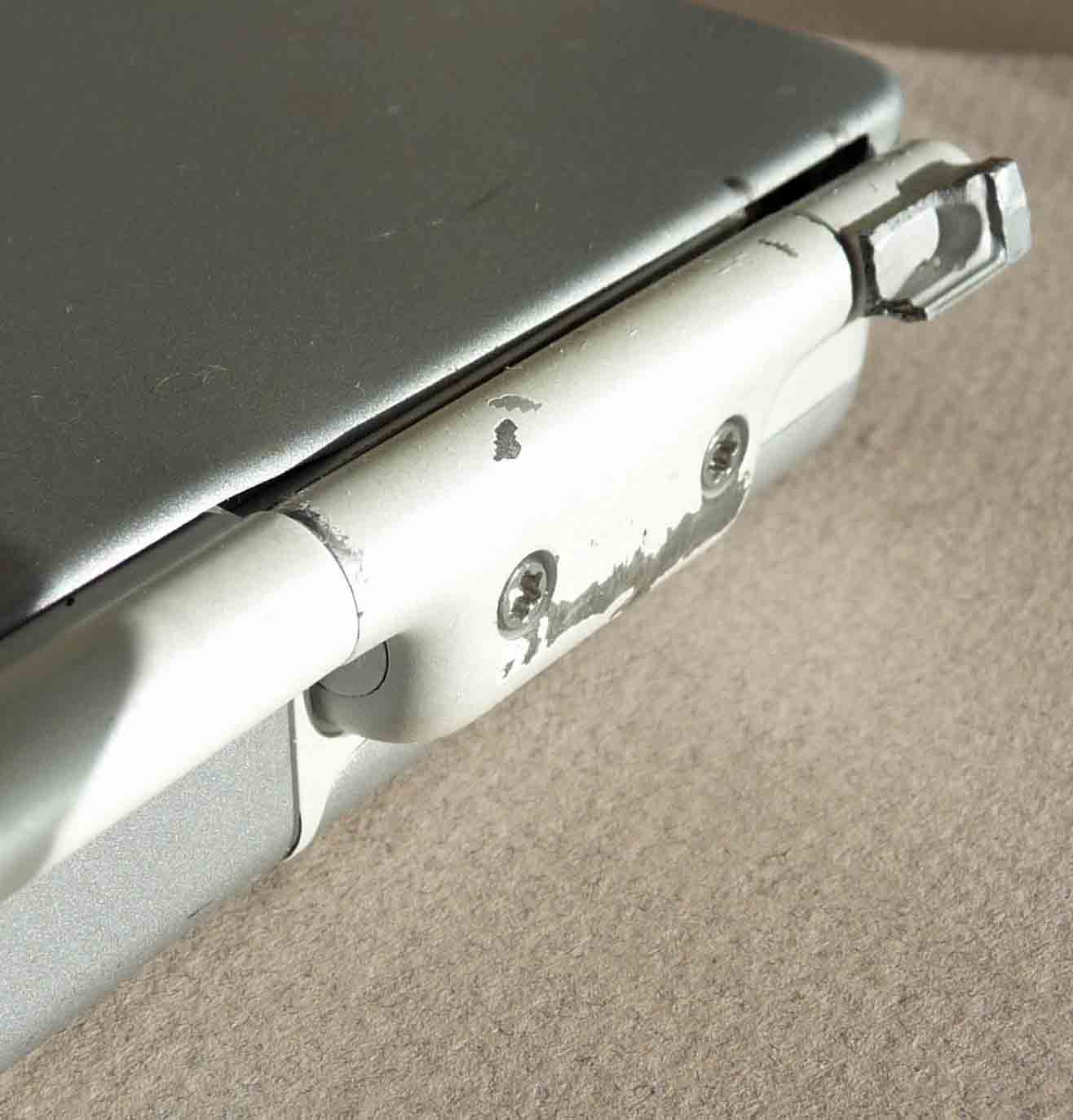

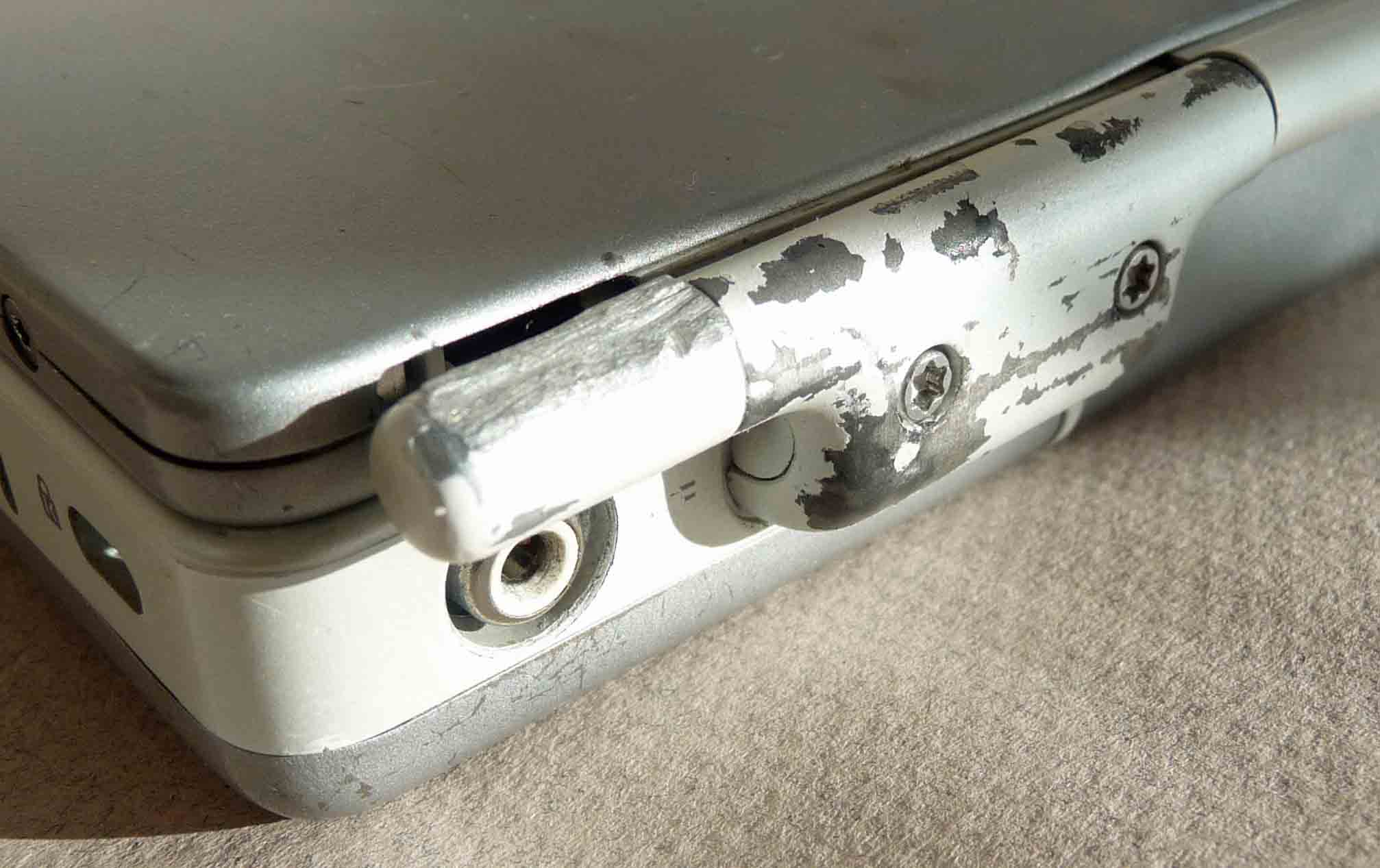

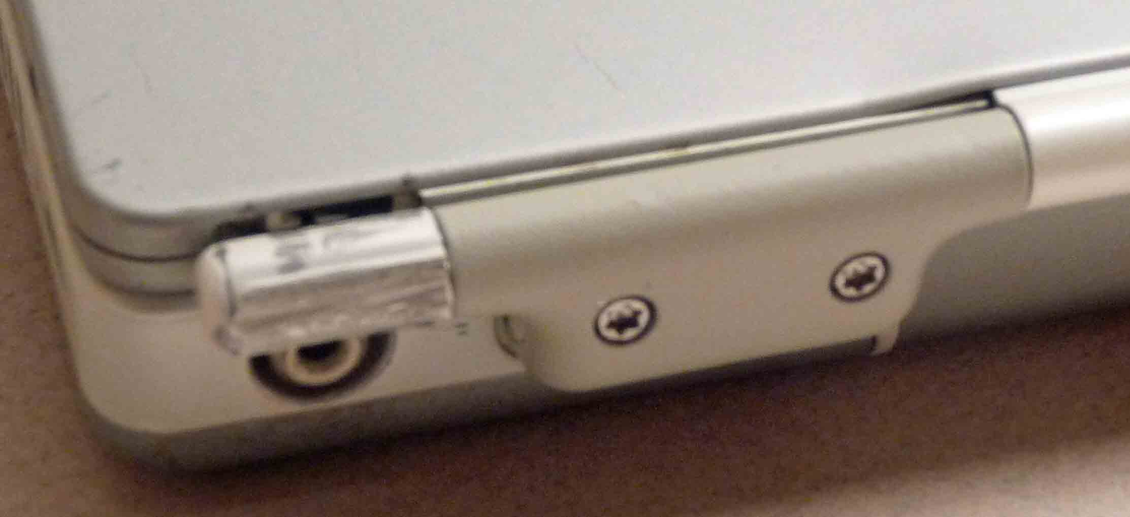

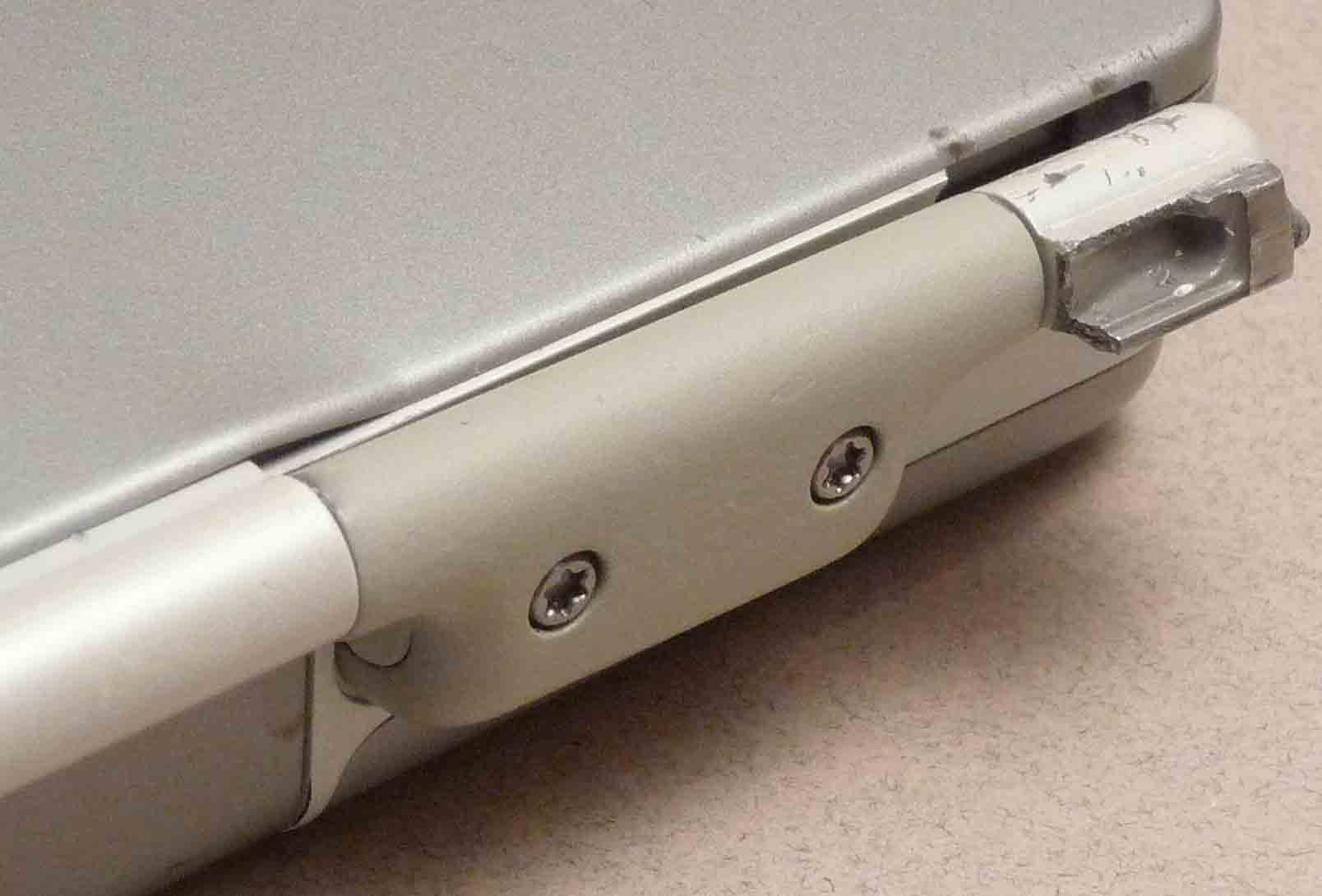

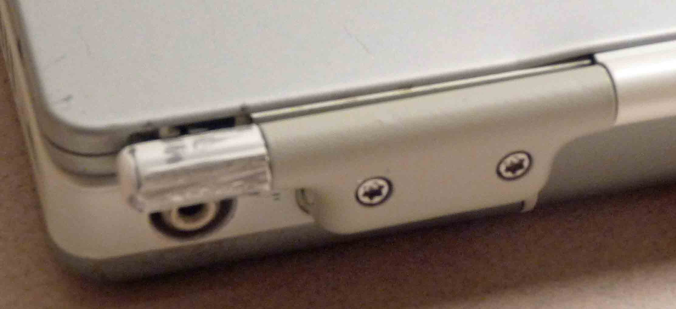

Following my post #9, here are the attempts to touch up the TiBook hinge covers using a small aerosol can, the cap colour of which seemed a near-perfect match.
Results whilst an improvement aesthetically, are not as good as I'd wished for.
I now plan to look around for a better matching aerosol.
Following that, I must find a solution to re-attach the screen/hinge supports (the photos show that both ends have fractured and torn away from the screen assembly).
What may possibly work is a gradual build-up of epoxy and then reform the reworked pieces to fit inside the screen assy, and epoxy in final position. Bit of a bodge-up I guess, but the alternative is to replace the screen, not only a very unpleasant task, but one which would not be cost effective, as this TiBook was a freeby.
Over the last 2 days I've had both seized hinges soaking in WD40. Even afterwards it was almost impossible to get them moving (with end-piece held in a vice). Then cleaned off the WD40 and applied a few drops of Break-Free (a very effective gun lubricant). After a few hours I was able to get some movement from the hinges, so although freed-up, the friction & torque to move them is still very high. Whether the screen assembly after an epoxy build-up repair would accept this torque without fracture, is another question. Must be a little mad to bother, but I guess that's why we're all still here!

Yeah, not a perfect match but it does look much better. Nice job on the spray.:)

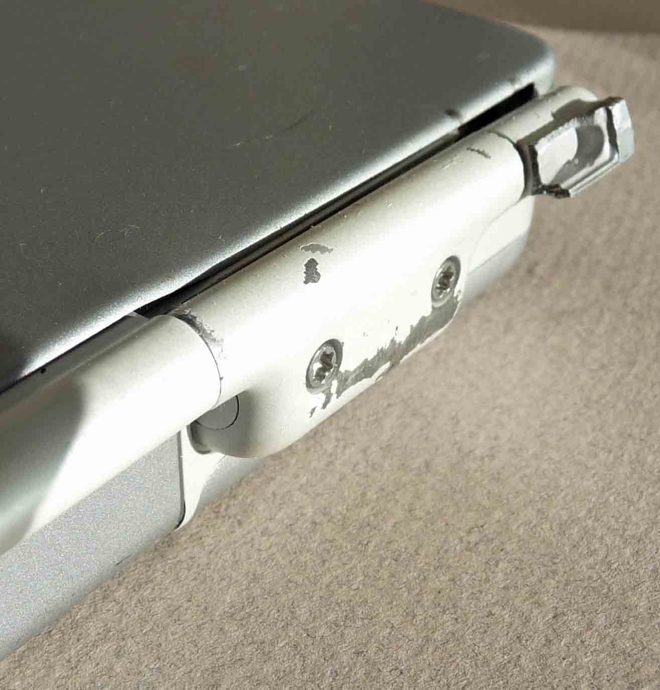

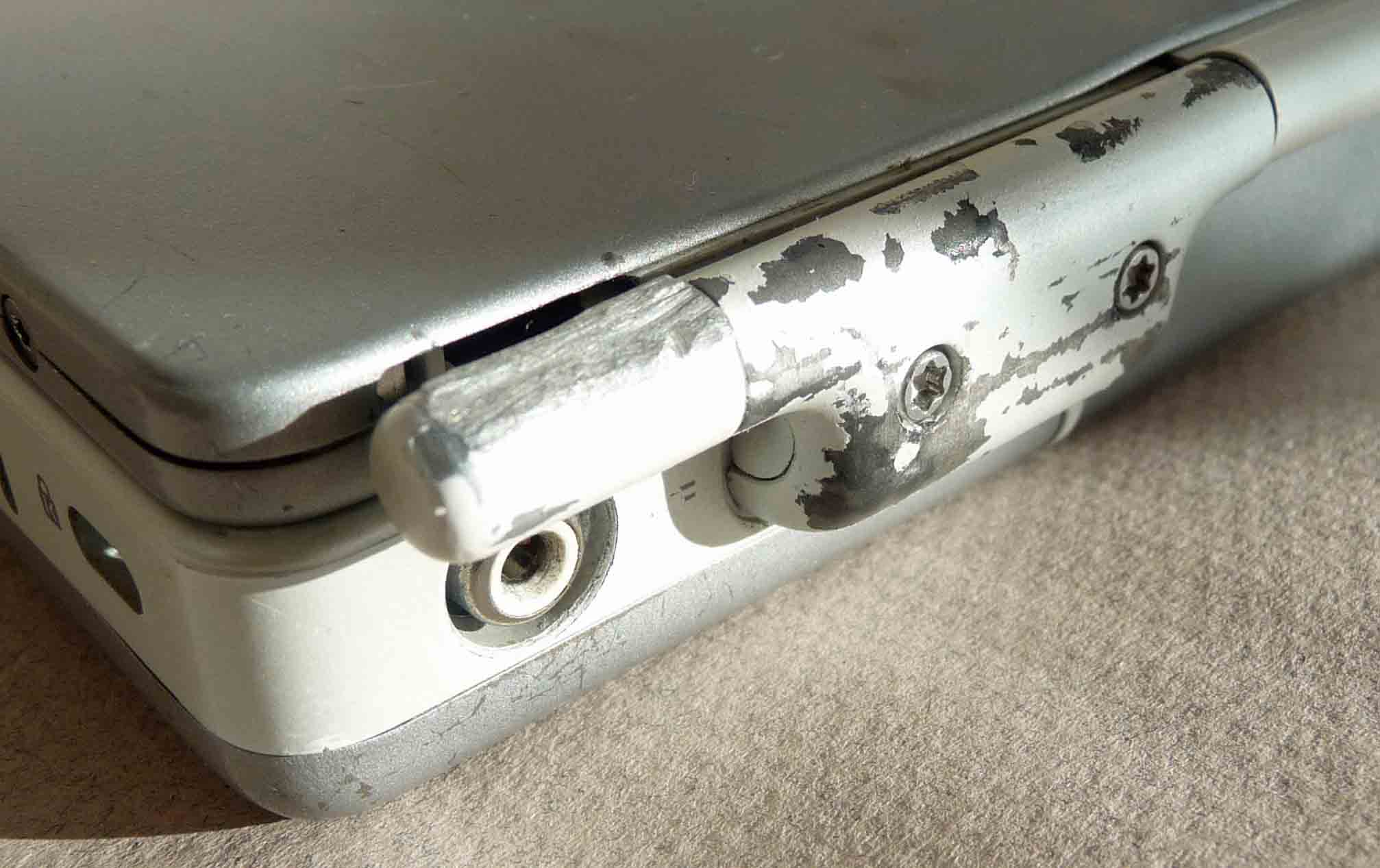

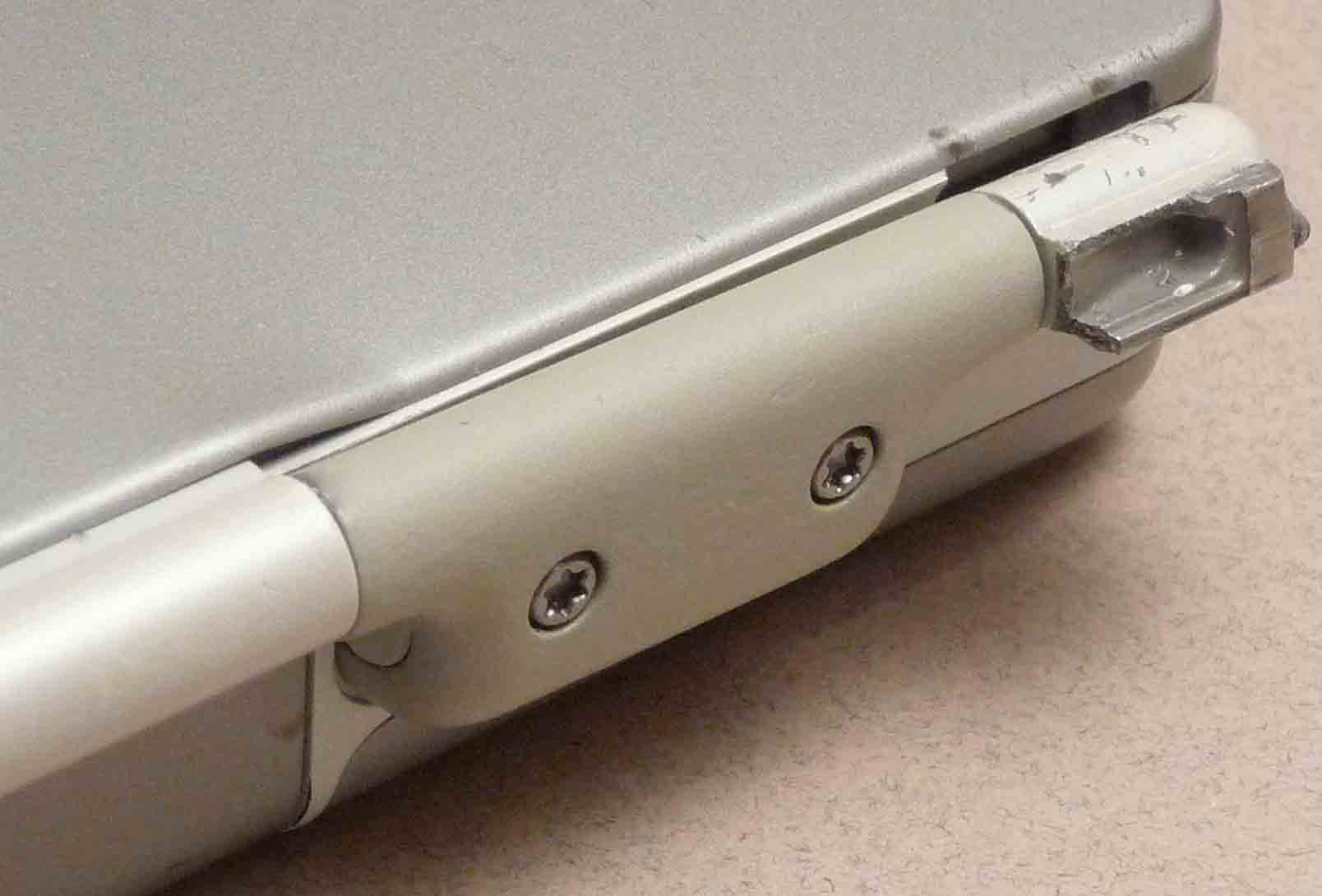

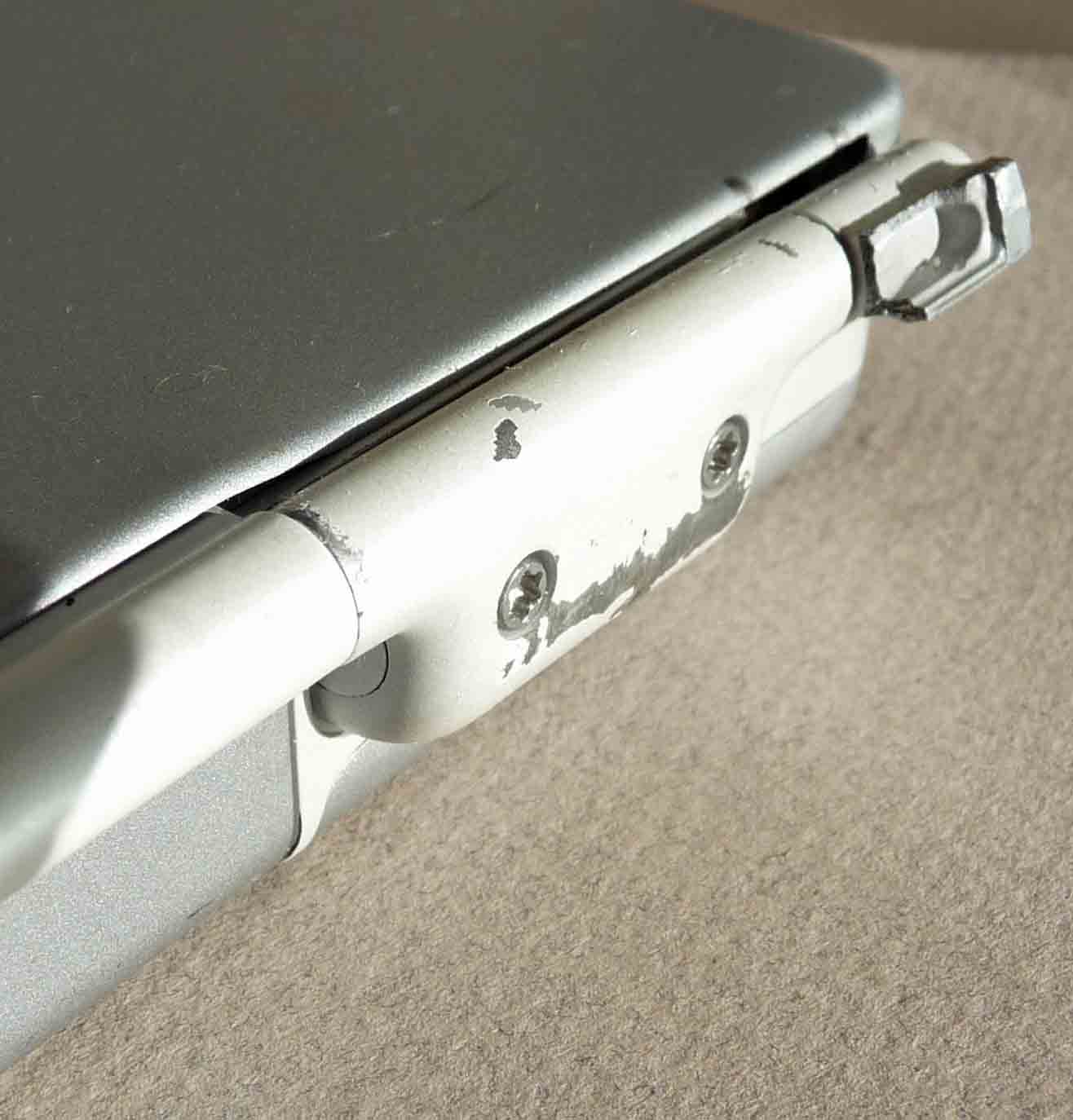

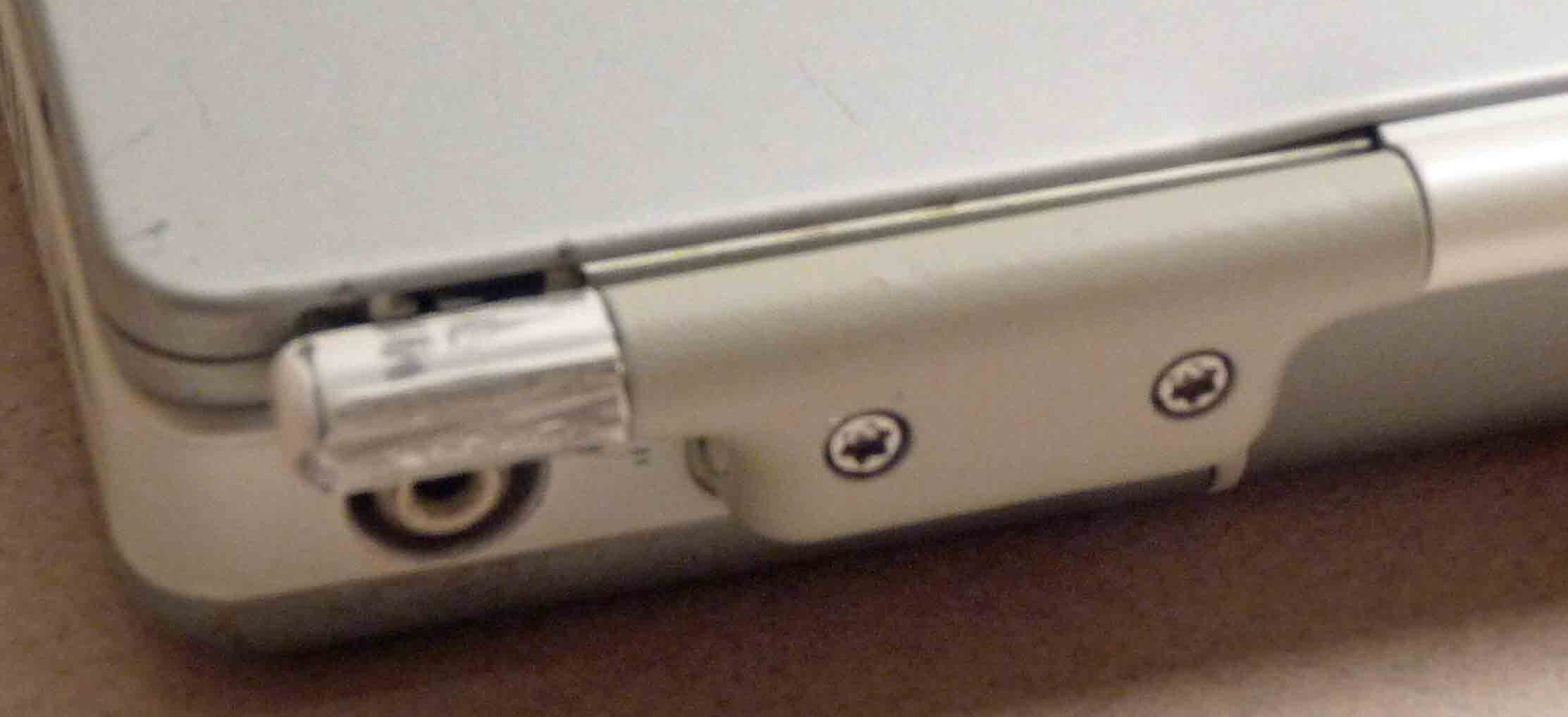

View attachment 612438 View attachment 612440
View attachment 612439 View attachment 612441
Get a set of Pantone swatches or paint swatches from a local paint dealer and approximate the color? I did have the Tipaint back in the day... it was actually not perfect either because the tibook paint gets a lot of oxidation and color loss/color change over time. I'd go for the paint swatches and eyeball it indoors and outdoors and get the most exact match you can find.
To take it one step further, a month or two back I visited an automotive paint store to get some touch-up paint for one of my cars. I have references that give the factory color code, but the problem was that every code I gave(the store sold PPG paints, but when the PPG color didn't match I started cross referencing to other makers codes) looked to be just a little bit off-both for the color on the outside of the car and the color in places like the engine bay that were likely original. With the quality control and general moral at British Leyland in 1970, it's also entirely possible that it didn't quite match the "correct" color when it was new :) . I knew that the car had been repainted probably 20-25 years ago. I had driven the car there, so finally I had them color match it electronically. Rather than the factory "Dark British Racing Green" it registered a near perfect match to "Jaguar Racing Green." The colors are close, but just different enough to be noticeable. They mixed up a bottle of the Jaguar paint, and it was a perfect match.
I say all of that to suggest that the best course of action might be to take the computer to a paint store and have them color match it. Virtually all paint stores these days have the equipment to do this.
