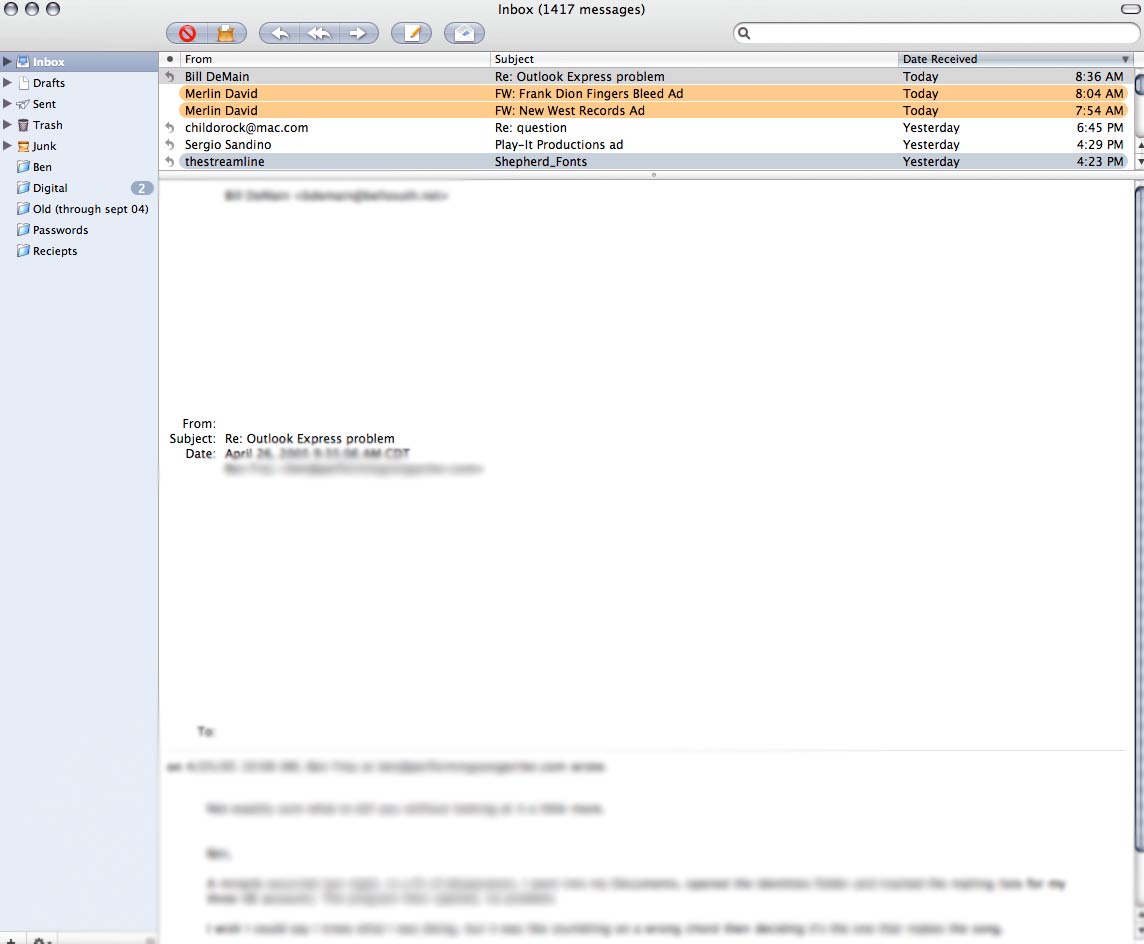

I have been getting this weird problem ever since I installed Tiger, and I can't seem to get it to go away.
The problem is those huge spaces on the "to" and "from" lines of the header info. I've had to turn the header info completely off because of it. Is anyone else having this problem, and if so, has anyone found a fix for it?
or at least a probably cause?

i've messed with nearly every setting in Mail trying to get it to not look like this. I tried turning off/on Smart Addresses in the Viewing pane in preferences, which does change how it looks, but actually it just makes it look worse. more garbled because more info is displayed when smart addresses are turned off.
I've tried changing my view font, doing customized header detail viewing options, etc.
it just blows, in general. Mail works better now, except for this annoying bug...

by the way, that didn't fix it.
when i tossed the mail.plist, i ended up having to re-import my mailboxes, which took about 10 minutes.
but it didn't change my problem. In fact, before I re-imported my mail folders, I looked to see if the problem was still there. I was.
and still is.
are there any fonts that this version of mail requires that the last one didn't?
i know all sorts of OS X programs seem to have their own "mandatory" fonts that aren't actually involved in what you see on-screen. For example, i disabled a non-system font that according to all of the "safe lists" out there isn't necessary for OS X operation, and i lost my terminal window. It was crazy. Terminal was open, and working, but the window would only take up about 10x10 pixels, and could not be changed. I was able to copy/paste into and out of terminal, though, so i know it was working.
Funny thing is, my terminal display font was set to Helvetica...which was active. Turned out that terminal uses some other obscure font that doesn't make sense to determine it's window size, or something like that.
I wonder if this isn't the same kind of thing. Is there an updated list of "necessary" fonts for 10.4?
because my Mail was fine in 10.3

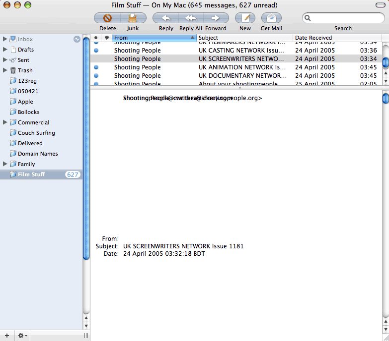

I recently formatted my hard drive and did a clean install of Tiger. Everything was working fine. However after installing some new fonts, and then clicking the 'Resolve Duplicates' option in Font Book, I have exactly the same problem as benpatient. See attached screen shot. Also, although it's only a small difference, the font for the number of unread messages seems to have changed. Take a look closely where '627' is written next to the 'Film Stuff' folder.
Does anyone have a solution yet? I tried deleting the preferences file as suggested, but this didn't solve the problem. All I've managed is to hide all the header info from view.
A solution would be much appreciated.

I solved the problem... if anyone is interested?
It's was pretty simple actually. But then it always is once you've found the solution!
Searching throgh my fonts in Font Book I discovered 'Helvetica' was disabled. Enabling it solved the Mail problem. I guess hitting 'Resolve Duplicates' after installing new fonts must have disabled Helvetica for some strange reason!
I also noticed that some of my Widgets, like the 5 day weather forecast, were using Helvetica as well.

Thanks for that. It actually fixed a problem I had with Terminal, too.
