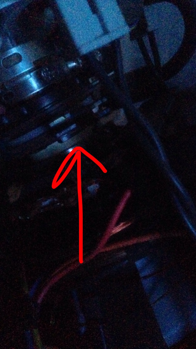

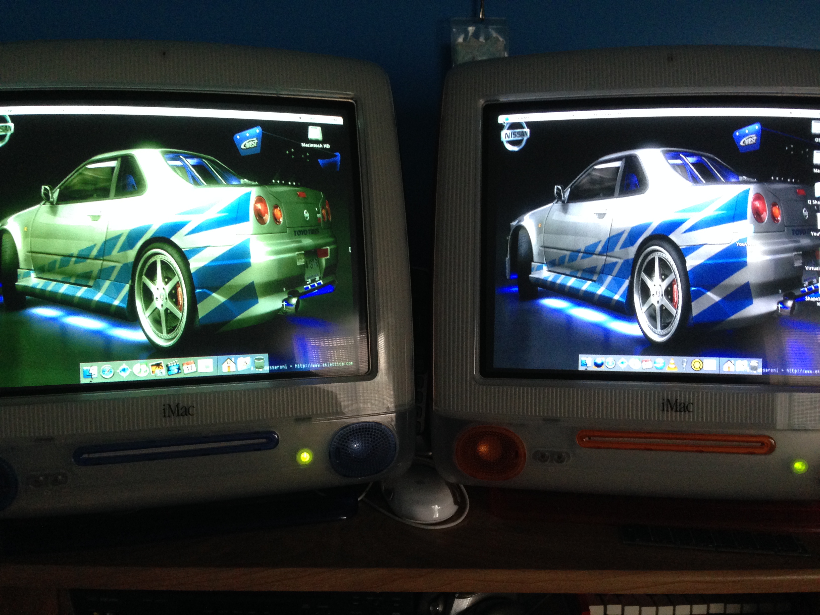

Ill post pictures if i have time as im heading home for Easter. My dad pointed out these knobs.. Ill snap a pic of that and what the screen looks like compared to my tangerine imac.

I dont know if i would call them knobs... In the photo with the arrow they are the metal sticks. According to my father, the electrician these are handles in which the CRT is manually adjusted. But i cant find any information on it anywhere. I tried seeing if my Tangerine model has the same but the orange plastic isnt as clear as the blue one is. \
Anyways. here are the photos. Showing my tangerine model on the right with proper colors and the indigo to the right..

Those are the focusing rings. Do not mess or adjust those. They are epoxied set from the factory.
They focus the electron guns and the other internal parts of the CRT. To correct the colour, you need to run the Apple service application that sets the colour or you can try calibrating it via OS X's monitor calibration feature.

did you even try using systempreferences -> monitors etc. to calibrate? Also OS 9 had software monitor calibration.
A certain hue or tint can be a sign for a defective flyback transformer, but the hue is pinkish then. There is a guide on the internet for the flyback transformer.
