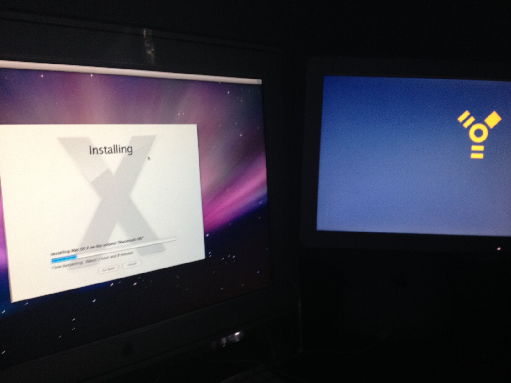

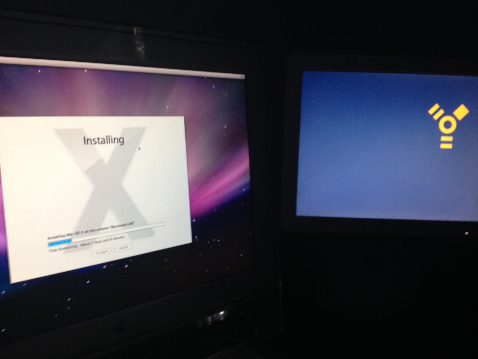

So LeopardAssist didn't work out so well for me, so I threw the iMac in Target Disk Mode and booted the Leopard disc on my G5 and installed it from there. So far so good, the install jumped from 2 hours down to 1 then hangs around the 50-59 minute mark. Now it's down to 40!
