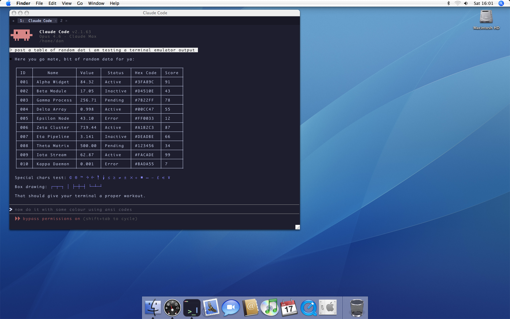

Tiger Terminal - A modern terminal emulator for PowerPC Macs
I've been working on bringing a usable terminal experience to PowerPC Macs still running Mac OS X Tiger (10.4). The result is Tiger Terminal - a self-contained .app that
runs on any G4 or G5 Mac with no dependencies to install.
What it does:
- Canvas-based rendering with Tk - smooth and flicker-free
- 256-color and true color support (Apple's Terminal.app on Tiger only did ~16)
- Full VT100/xterm emulation - vim, tmux, htop all work
- Tabbed interface (Cmd+T, Cmd+1-9)
- Mouse tracking for interactive apps
- Copy/paste, scrollback, font resizing
- Catppuccin Mocha color scheme

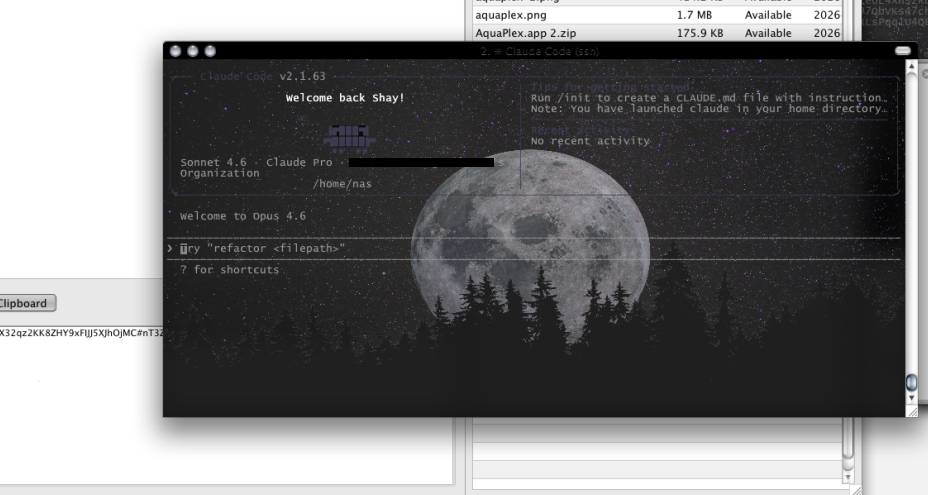

Added full Claude code cli support (via ssh) for the vibe coders who want to use their G5 as a terminal input machine.

Claude Code/Codex/OpenCode all work in iTerm 2 via SSH - although I have no idea if the last version supporting Tiger does. Curious to know more about your cross compilation setup... are you using a network share for both devices, running `gcc` on a Linux box and then once the object files are compiled, you invoke Tiger's `ar` to link everything?
