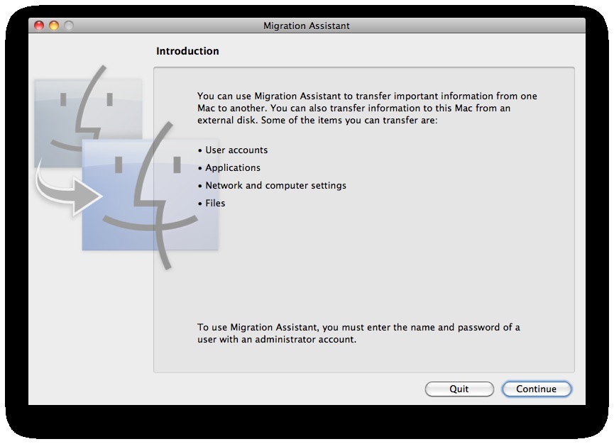

There are folders that you can copy across no problem but it can be a bit of a pain to do it manually if you are unsure of what to copy. Thankfully OS X has got you covered, in the Utilities folder you will find a program called Migration Assistant (it is actually present in Tiger as well iirc). This will do all the work for you. Plug in your cloned drive, the one you created from SuperDuper, and run the program. In fact you are prompted at one point during the Snow Leopard install to use this program, you can skip it at the point and run it at any time later on but I figure you may as well get it set up right in the beginning.
edit: I have no idea why the screenshot has that black border, Snow Leopard bug. Migration assistant works with USB drives as well.
