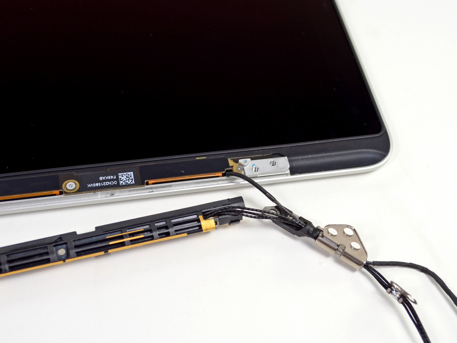

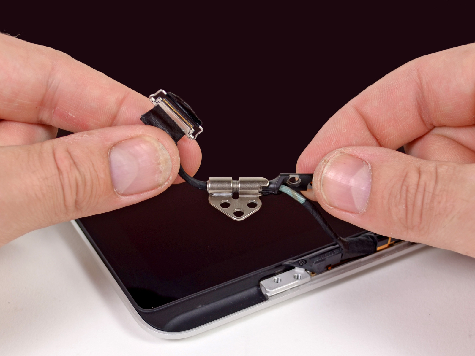

well, ifixit sent me a reply and this is what i got.
Unfortunately, that is the hinge it self, and loosing the hinge inside the computer would only end up damaging the machine. If you have more any questions or concerns, feel free to reply to me. Hope you have a excellent Thursday!
i thought this is the case, because i observe the pictures of the hinges very closely on their teardown and it doesn't seem like the screws have any measurable influences on the stiffness of the hinge. it look like i will have to deal with it now. i'm done here, thanks everyone for posting.
here are some pictures of the hinge from ifixit to show what i'm talking about.

Hmm, interesting. So the Apple guys didn't really tighten my hinge? And the hinge is non-servicable in terms of tightening/loosening? That's good to know, thank you for researching this!
