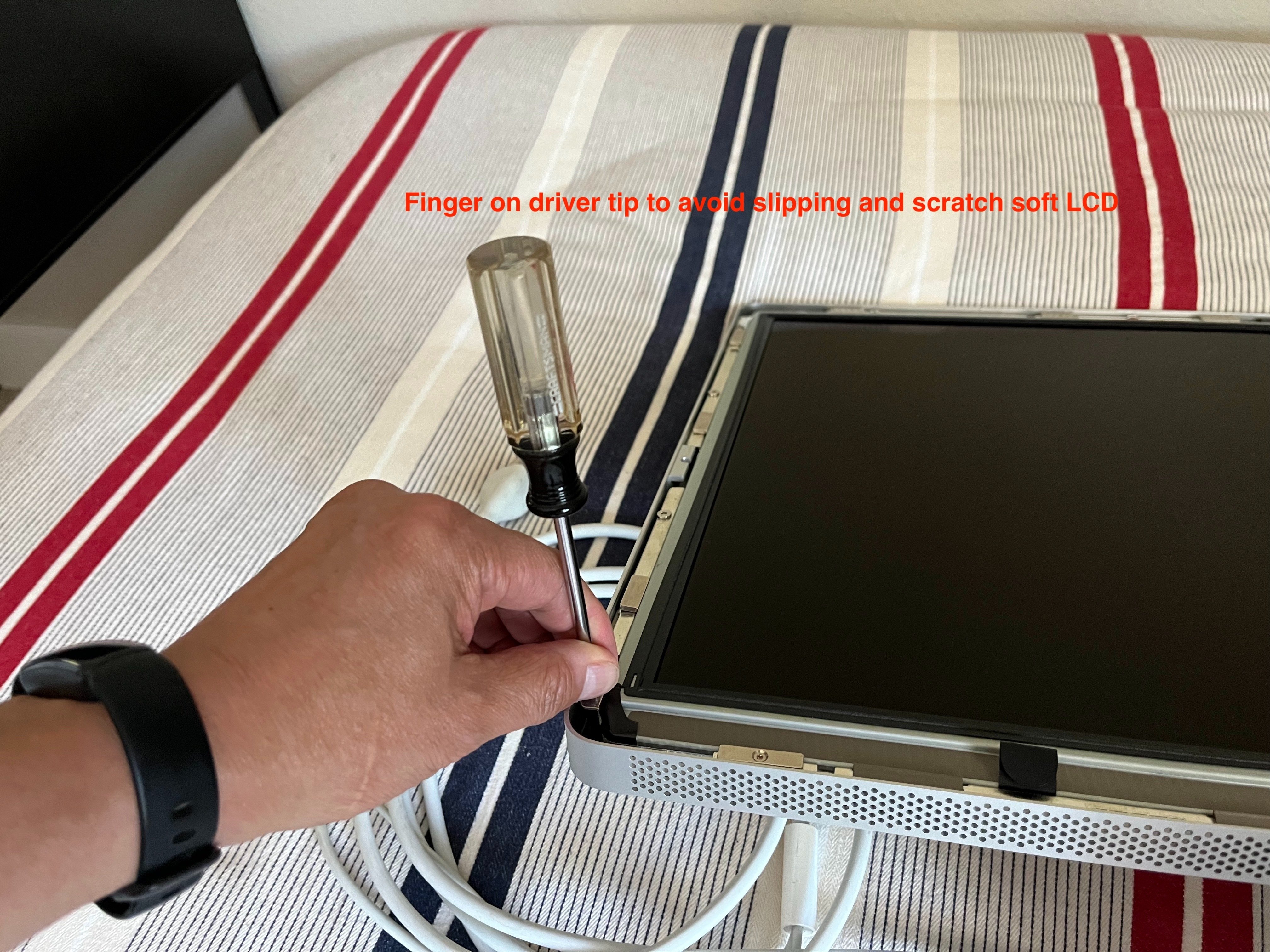

Quite a few screws was several turns loose. Tighten them and quieted it down. Quite a surgery of course and easy to get dust in btw LCD and diffuser requiring 2nd disassembly to clean off (can't see result of first pass cleaning until LCD is on again). 2-3 hours even with experience (I've done like 20 of these, mostly Thunderbolt Displays with blacking out backlight)
While there, I reflowed the LED bar connector solder points as preventive for blacking out backlight problem. Occurs mostly on 27" Thunderbolt Displays (same LG 27" LCD+backlight panel) but have seen it on 1 A1312 iMac.
