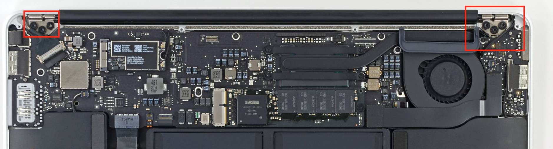

The screws that attach the screen to the top case are fully exposed. I recall swapping screens on a few a1466 Airs without much disassembly.

Yes they are, but the ones that needed tightening on mine was the other side of that hinge..in the lid..
