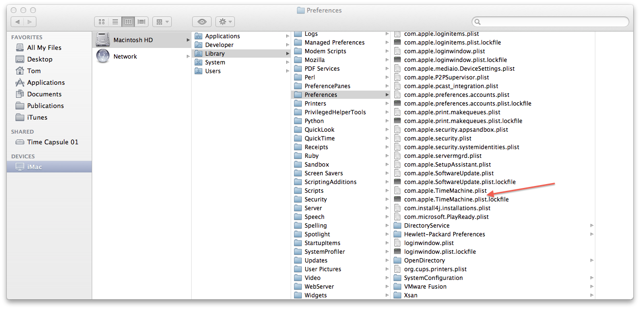

you sure its in library/ preferences? i can't find it. i skip to T and all i find is terminal and textedit files.
Open Finder and select your Mac device. Then select Mac HD (or whatever your disk is called), then Library then Preferences.
yes i did that. it comes up with all the files with lockfile and plist. but there is no time machine files there.

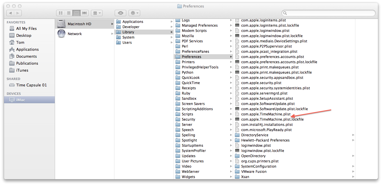

From your previous post, it was clear you were looking in the {user} library preferences since you mentioned terminal and textedit. Here is a screenshot of my Finder.
oh ok, sorry. found it. so do i delete the files that i copied to the desktop or in the preferences folder?
First, turn TM off. Then delete the two TM plist files in the Preferences folder. The copies on the desktop are just in case we need to restore them back.
Reboot, erase the TC disk, turn TM back on, set up TM to use the TC disk.
BTW, this is my last best shot at this, so here's hoping it works.
