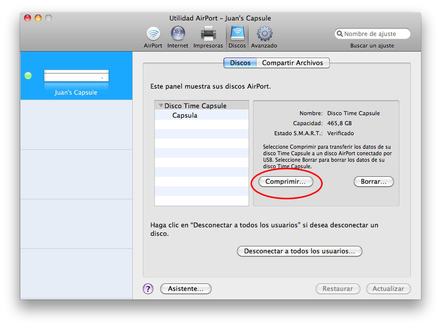

Compress Disk.
I have my music and no so used data into my time capsule drive. Time capsule make my backups daily, but then I use another external drive to backup the whole TC. You can do it whit something called "Compress" (I guess it is the literally translation for the Comprimir button) in the TC panel in Airport Utility. What it makes is a full copy of the TC on an external drive. It wold take time but it wold make you feel safer.
Give it a try and tell me what you think.
