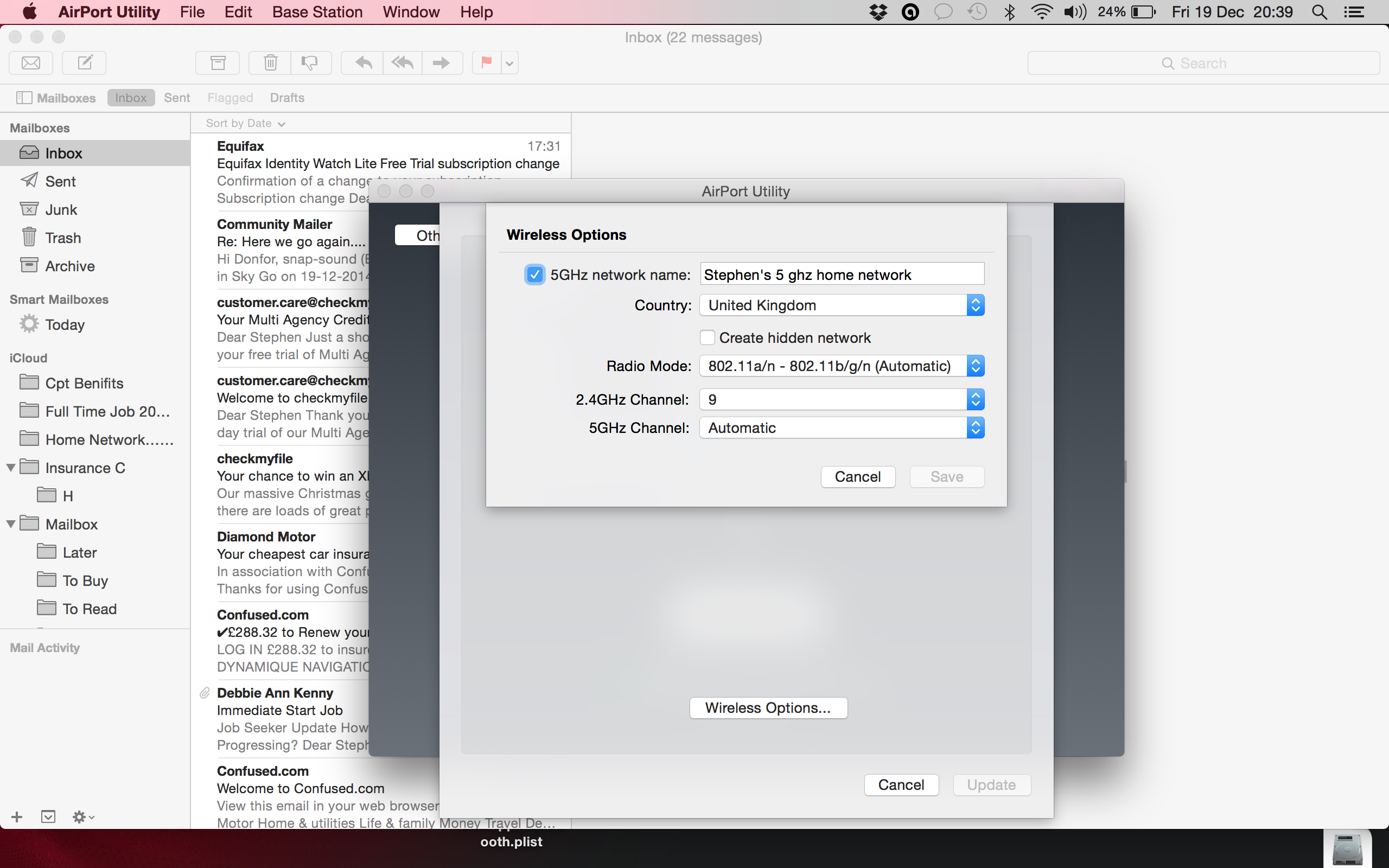

I use sky fibre broadband and airport extreme (not a time capsule though is Apple router)....wifi and or ethernet
work well my airport is set use bridge mode, think your time capsule will be a similar setup
trie setting your time capsule to router mode off (bridge mode)

You would run an Ethernet cable from the Sky provided router into the WAN port on the Time Capsule. You can either use bridge mode on the Time Capsule, or set the Sky router/modem to bridge mode and enable DHCP & NAT on the TC.

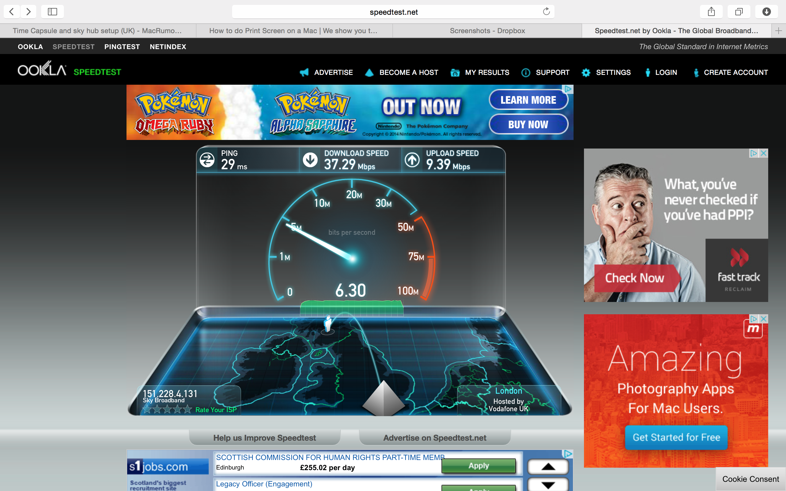

However my BB when Sky tested is averaging 12Mbps anyway, if I'm on WiFi on my iPhone I run a speed test app I get 8-10Mbps from the Sky hub anyway, so do I need 5GHz WiFi?
