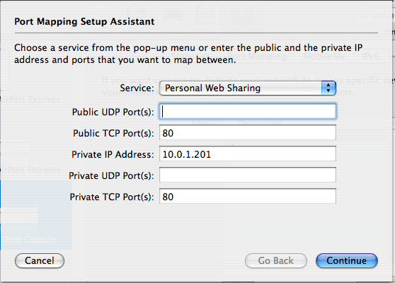

  • port forward 80 and 22 on time capsule via airport utility

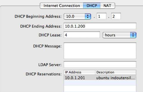

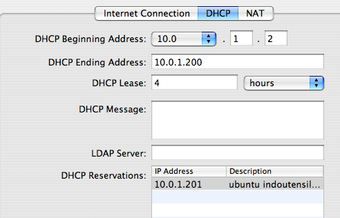

  • reserved a DHCP ip for ubuntu server (10.0.1.201) via airport utility

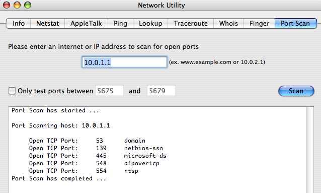

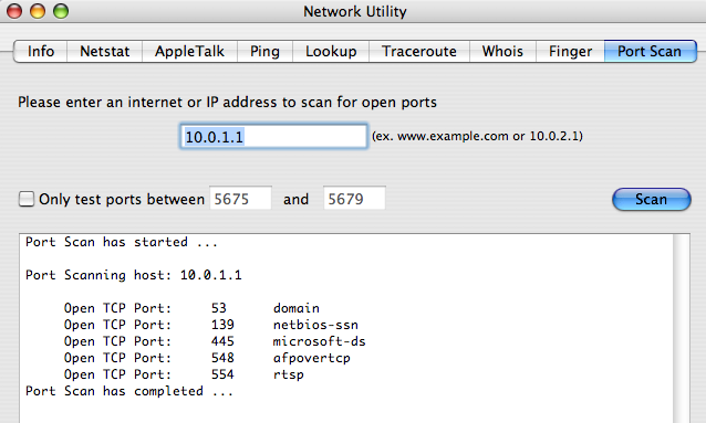

  • port scan on time capsule (10.0.1.1) does not show port 22 and 80 open even though i've setup port forward for 22 and 80

where are you trying to connect from? sometimes trying from within the network can get a bit weird.
i would try the same tests here, but my network utility keeps crashing 🙁
it might be your ISP is blocking 80, i've had that happen in the past.
try moving your server to 81 then you can forward 81 to 80 so inside your network would stay the same but you would have to add a ":81" to the end of the base address so ".com:81/_____" or "##.##.##.##:81" if you're using an IP address to access from outside.
I've also had problems connecting to 22 from within a corporate environment (trying to SSH home from work)
has your server taken the new address?
try ifconfig on it to see what your address is. if it's not correct "sudo /etc/init.d/networking restart"
