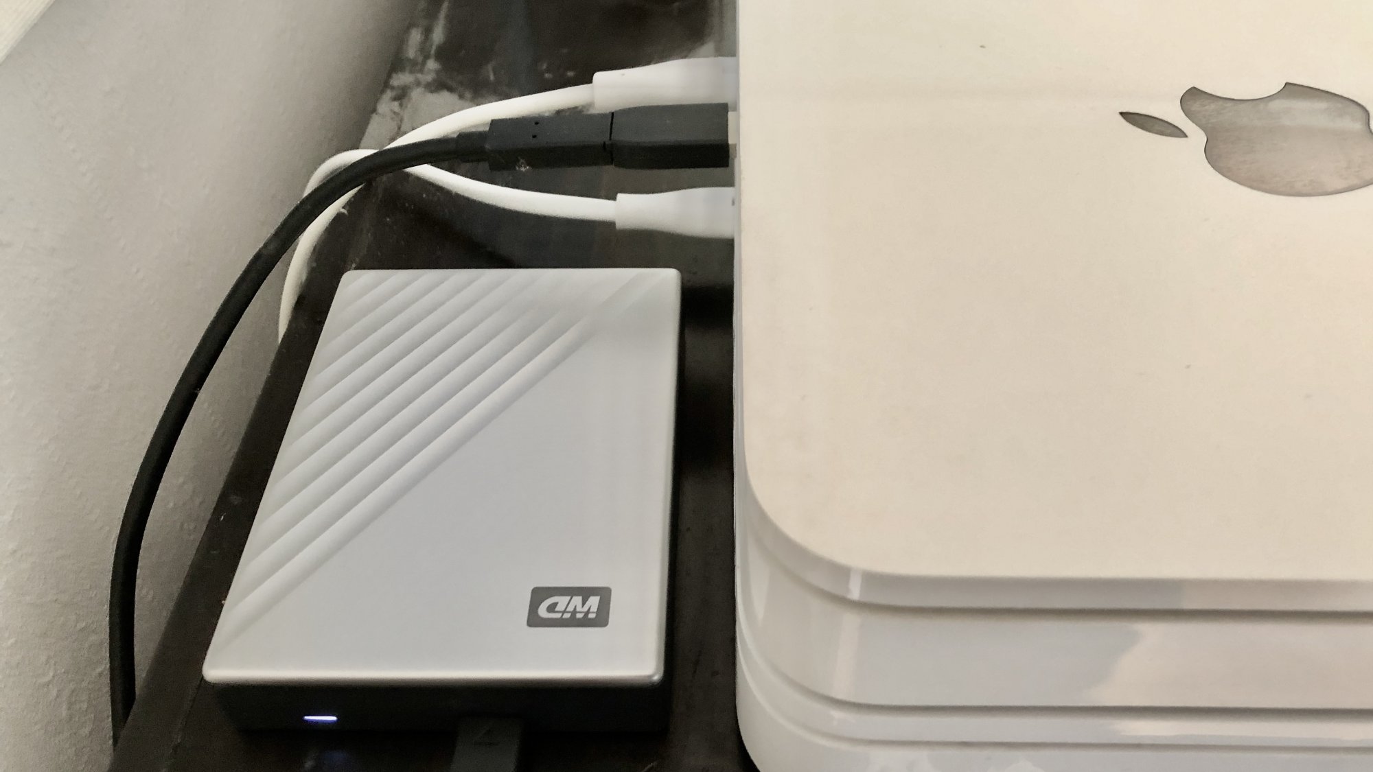

I am pretty sure the router part is still working. I just ordered this external hard drive. Unless someone can suggest something else. Open to all suggestions.

It will work fine. When the WD disk is connected to the Time Capsule then in Mac disk utility select the new WD disk then click erase and select the Mac OS extended option. It's then being formatted to Mac OS. On the Mac Time Machine settings add the WD as a new disk and it's ready to go, good luck.

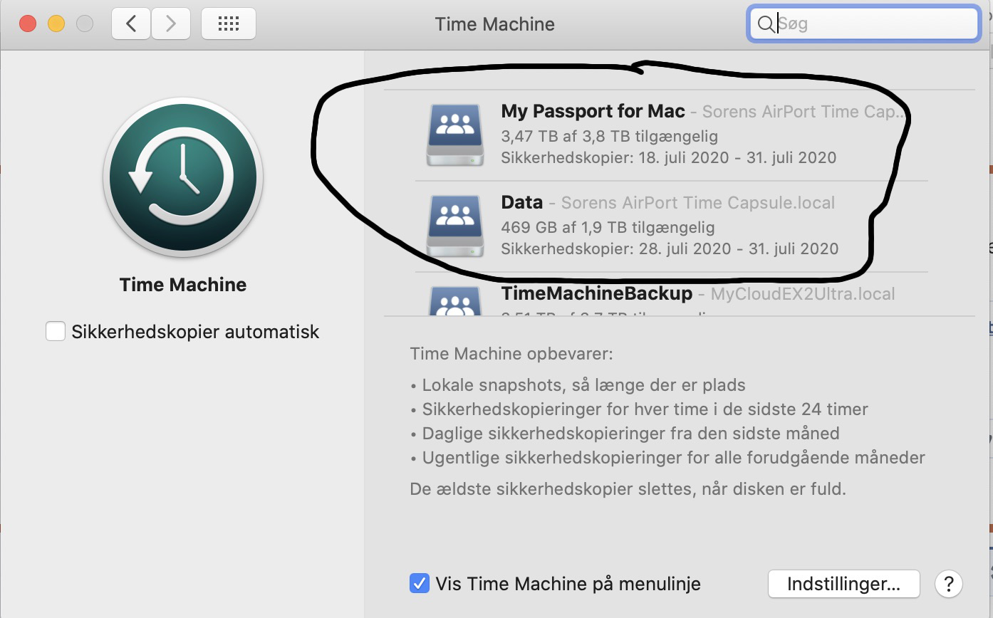

Since I am not very tech-savvy. I have a question? If I get the external and attach it to the time capsule, can I have my MacBook pro backup to both at that same time? That way I have 2 backups?
Yes, after adding the WD in the Mac Time Machine settings you will backup to both disks, see below (sorry it's in Danish language 🙂 ).
