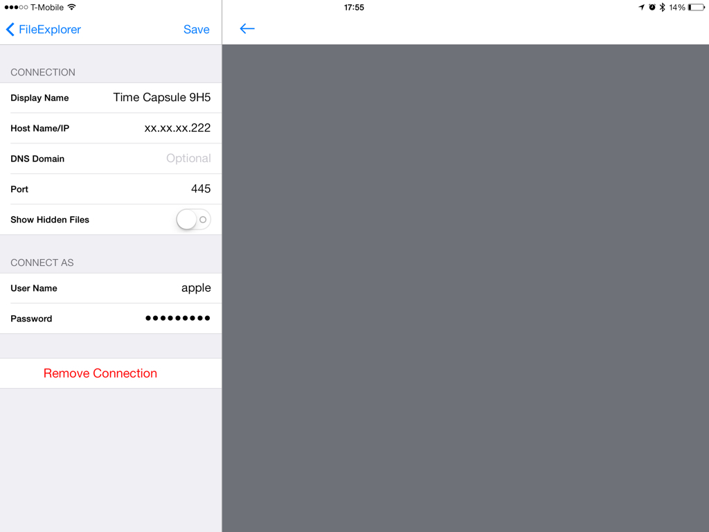

Time Capsule file server access outside LAN.
Thanks for the response!

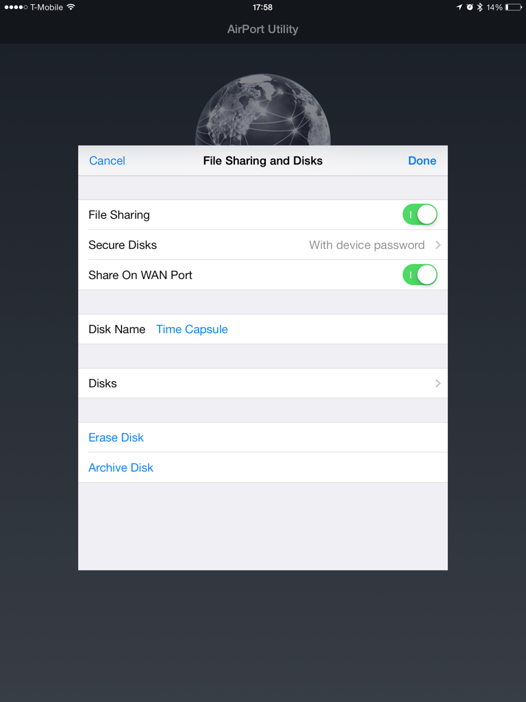

a. I had "Share Disks over WAN" checked in AirPort Utility already.
b. I'm using Comcast Blast! with a Motorola SB6120 modem.
c. I was already using my external IP with the app. (The x's are replaced by the actual IP.)
I have screenshots attached of my configuration:
18:00 update: The external IP no longer works locally either.

No dice, even after resetting the router completely. The external IP is working locally however.
I did a little test. I enabled Personal Hotspot on my iPad and turned off Wi-Fi. I connected the iPad to my PowerMac G5 via USB and unplugged the Ethernet. I connected to the server afp://MYEXTERNALIP in Finder, and it worked! So I'm suspecting it has something to do with the protocol used by FileExplorer. I think it's SMB?
