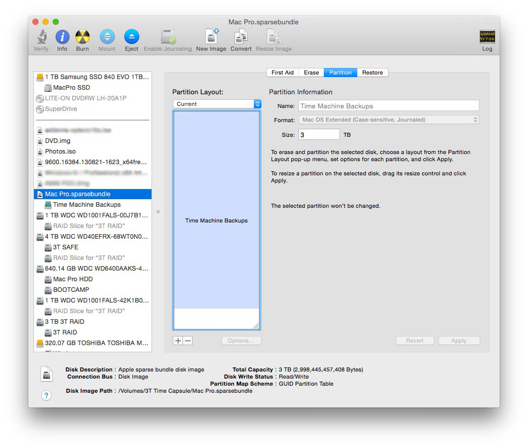

BTW it doesn't seem possible to run Disk Utility on the Time Capsule drive. Even when it's mounted so I can write to it from the Mac, it doesn't appear in Disk Util. There doesn't seem to be any way to troubleshoot the actual drive.
Thank's strange. I am using the Mac Pro 2009 (Flashed to 5,1) with 10.10.2, no problem with the Time Capsule. And the disk image actually shows up in disk utility when mounted (backing up).
My understanding is that's a network disk, we can only manage it through Airport Utility. In disk utility, it won't show up network disk, but only the image mounted.
Anyway, for OP, did you try to shut down BOTH your Mac and the TC, unplug the power cable, wait for about 1min, and then start up everything again?
