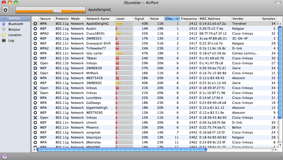

Download iStumbler and see if you are competing with someone else on the same 2.4 gHz channel or there is a lot of interference. Change the channel to see if it improves. If not I would get an new AEBS with dual channel or run the trendnet for the G devices as suggested.

I d/l iStumbler and it looks like my router should be free and clear. I want to try and AEBS...
But, will that really help me? I supplied an attachment from iStumbler.

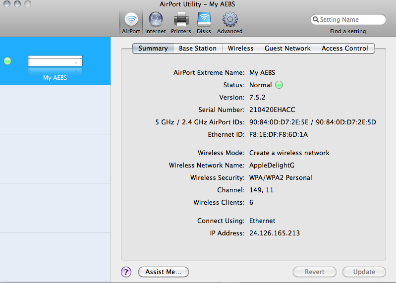

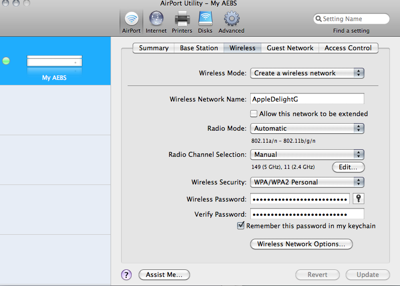

Perhaps one of my settings is off. See attachments.

I am out of ideas. I tried interference robustness. Increased signal strength, but not throughput. I have tried turning off bluetooth and turning off the both BT devices (keyboard and magic mouse) and it got better but still not to the level that it should be. I have got the same speeds with both BT devices on and connected.
I would ask this question: Should the router be located on the first floor or second floor? Right now, it is on the second floor. It is not possible to move it to the first floor, but could explain my issues.
I have seen data rates (as reported the Airport Utility) from as low as 1 to as high as 145 on my Macbook on the 2.4GHz network.

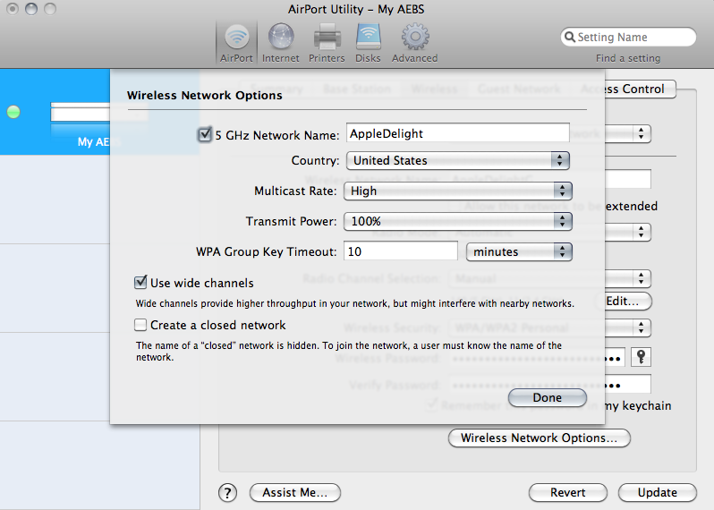

For the Radio mode, I have it set to Automatic (which sets it to 802.11 a/n - 80211.b/g/n). The other option is 802.11a - 802.11b/g. I have only 1 n device that is 2.4GHz (iPod touch). Would changing the radio help? I have tried channels 1, 6, and 11. 6 and 11 (mostly 11) gives the best results. Changing the channel (set to 11) probably won't help any further.
Under wireless options: I have the multicast rate as "High." Transmit power "100%" and wide channels is checkmarked.

I do live in a highly dense area and there are numerous networks around me. I used iStumber and found that my signal strength is around 50% and noise is around 13%.
