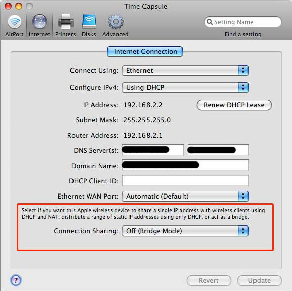

Dumb question but how do you put the TC in bridge mode?
In Airport Utility, click on the Internet Tab. It's the bottom option: Connection Sharing.
-Kevin
