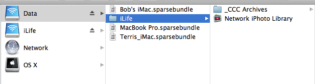

Basically I'd like to use the shared iPhoto DB / but also have it backed up to my time capsule. When I view the TC drive I only see the 3 computers sparsebundle images but no iPhoto DB backup.

Well it looks like CCC works better than SuperDuper. I'm a bit disappointed since I've been using SuperDuper for years. I thank you for your help, it's appreciated. I made a folder on my TC drive / chose to backup the external iLife drive to TC and it appears to have worked perfectly.
