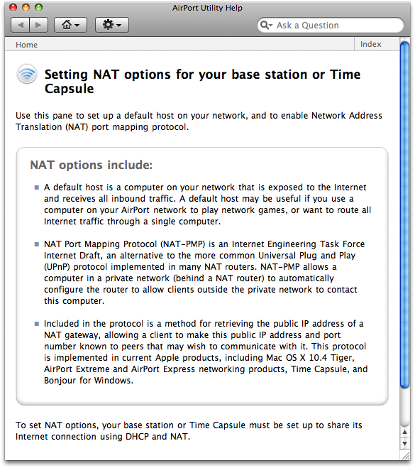

Is there a way I can turn off Time Capsule's firewall just for one device (say, a Nintendo Wii)?
Is this (the "default host" NAT option) what you're looking for?
