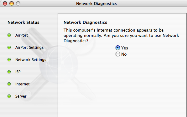

Did you try running network diagnostics before posting?
This will tell you where the problem is.
Run Network diagnostics, snap a picture and POST it here.
Wherever there is not a GREEN LIGHT on NETWORK DIAGNOSTICS is where the problem is.
--Eric

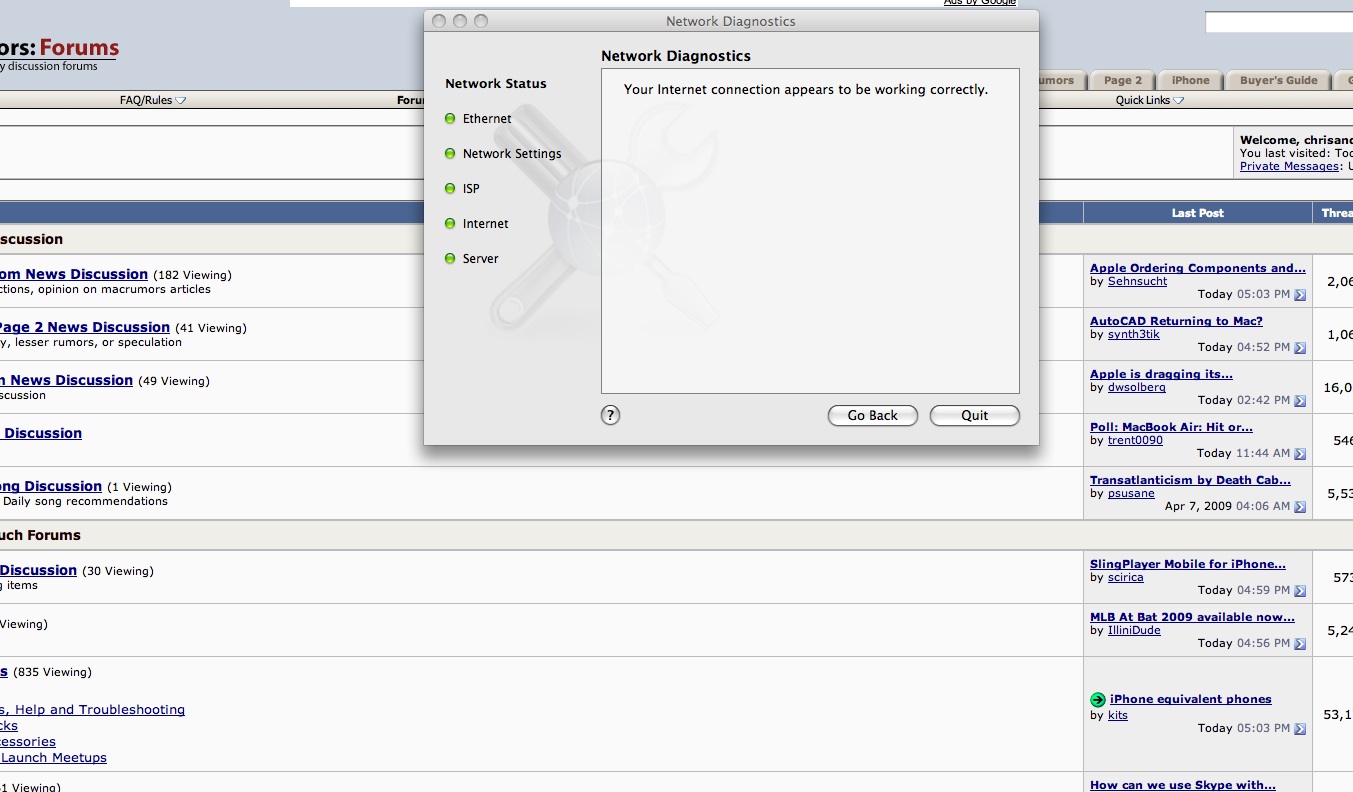

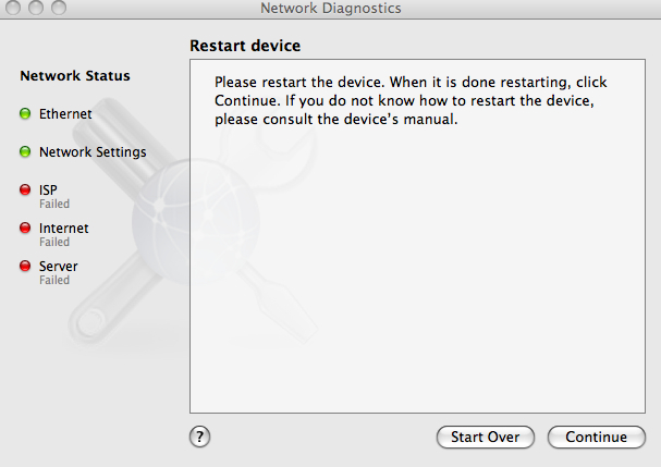

Well, it just happened again before I could read your post. Ran network diagnostics and reset the DSL modem. Still, nothing. So, I unplugged the TC. I have noticed that the HD was not spinning when this happens, so I hope I haven't messed that up. It immediately started up and connected to the internet. Here is before and after screen shots.
Maybe it is the DSL dropping out.

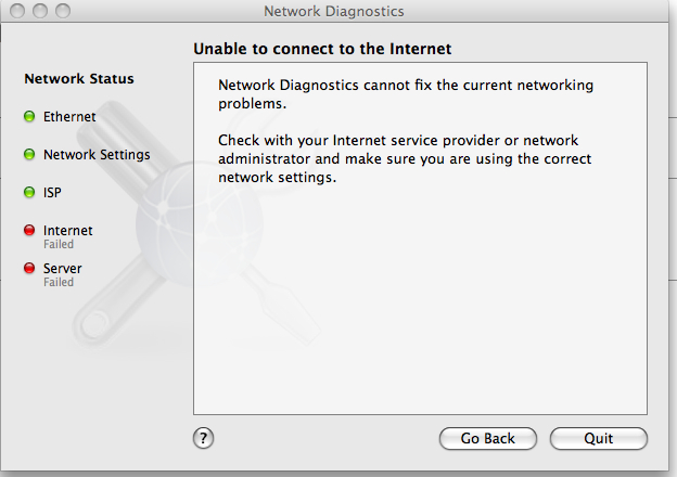

So, I reverted back to 7.3.2 and now I had two problems come up: PPPoE server and Internet Connection. Ran Network Diagnostics and reset the modem and the ISP went green (screen grab)
In Airport Utility , changed always on to Automatic, disconnect never and I got an IP address of 0.0.0.1. After updating TC, IP address came back with a real one.
So, why didn't 7.4.1 report any problems?
And, what the h**l is going on with the IP address.
