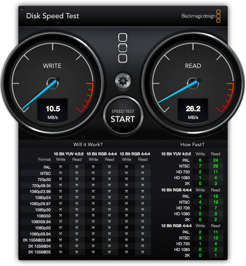

That is definitely an option. Most any chipset in a router is not powerful enough to handle USB 3.0 speeds, let alone USB 2.0. It is kind of a gimmick in consumer grade routers to offer USB 3.0 but not allow users to take advantage of it. Try downloading BlackMagic Disk Speed Test from the Mac App Store to test speeds on the drives.

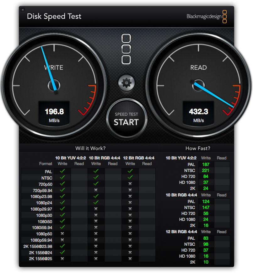

Here's what I got when testing with BlackMagic. I also included the scores for the Mac Mini's internal SSD drive and the USB drive as well.
Seagate 1.5 TB USB 3.0 drive connected to Netgear R6250:
10.5 up/26.2 down

Intel 330 SSD internal SATA drive inside 2012 Mac Mini:
196.8 up/432.3 down
Does the format of the USB drive connected to the Netgear matter? I may have it as FAT32, but need to check.
