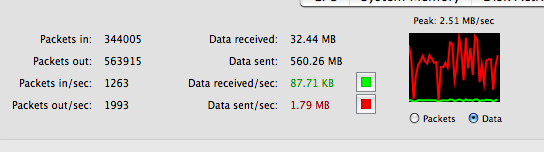

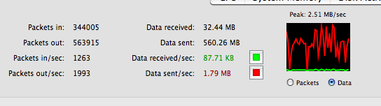

using an iMac 2ghz core2, getting around 1.8MB transfer rate. That is with Mail/Safari and all other apps that might use wireless modes shutdown. I used the info from Activity Monitor in network screen.
