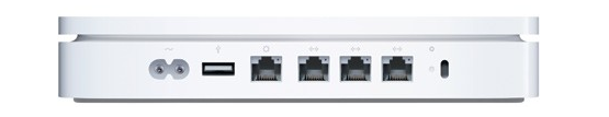

I'm a little confused. So Wireless router, connected to the TC (via wifi) all works fine.
When you connect another device to the TC vie ethernet it stops working? Is that correct? Is it plugged into the three output ethernet connectors, rather than the input one?

Is it the same as the picture? Mine is, and I plug my Laptop into the Ethernet sometimes (because its dog slow anyhow) with no issues. The wire has to go in one of the three with the ↔ symbol though.
Yes exactly the same as in the picture, and I have tried all <-> ports..
