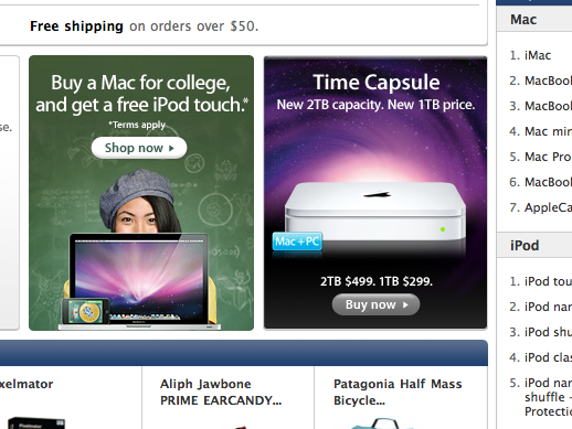

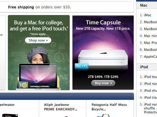

BTW, Apple just came out with a 2 Tb drive; I was online at the Apple Store website a few minutes ago and the graphic is up, but clicking it leads nowhere:
Yeah I woke up saw it was cheaper. I then went to my work and price matched and it went from $459.99 to $299.99. I'm just waiting for my work to update our stuff and then I will get a little more off with my employee discount. We still have it listed as 499.99 it will take probably until tomorrow to update our site. Thanks for the heads up as well.
