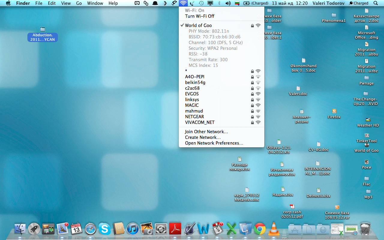

that means you should be connecting via 5 ghz, but i don't remember how to force it on the time capsule.
Retrieve the wifi detailed info by holding option and click the wifi icon on the menu bar, as per the post below
http://osxdaily.com/2011/06/15/get-detailed-wifi-info-from-the-menu-bar/
take a screenshot of the info that you see and post it here.
Your signal strength (RSSI) is good and you're connected at 5 GHz with a 300 transmit rate. The connection looks as fast as its going to be using current wireless and I am afraid that there isn't anything that you change to make it faster. Let's hope that the new gigabit wireless tech is adopted in the near future.
