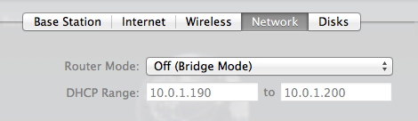

I did the exact same thing recently.
I disabled the wireless on the TC, and connected via Ethernet to my computer and I was getting the yellow flashing light.
Now _ I did 2 things at the same time so I don't know which one turned the light green but.
I set the TC to BRIDGE MODE
under WIRELESS mine is set to OFF
and under NETWORK it is set to OFF (BRIDGE MODE)
and then I configured it to ignore any errors
The two errors are
INTERNET CONNECTION
and
NO DNS SERVER
Now it stays green, even when the computer is asleep.

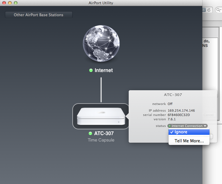

But how to "ignore errors"?
Thanks all; I have all my settings as McGilli describes; what I can't do, however, is figure out where to go to configure it to ignore errors (INTERNET CONNECTION and NO DNS SERVER). I sense I am being very dumb, but can someone point me in the right direction?
Hope this helps
