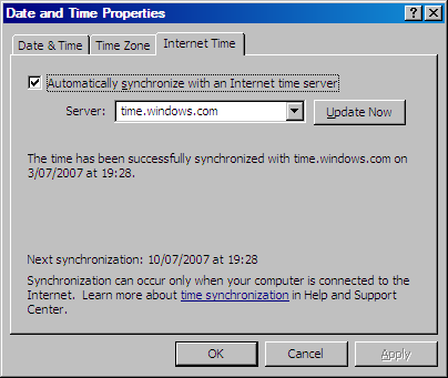

The reason for the date difference is that Windows bases it's time directly off the system clock, without any time conversion. OS X sets the system clock to GMT and then converts for display (this behaviour has existed since the days of DOS). So after being in OS X, the clock is in GMT so is 8 hours behind when you're in Windows. If Windows then updates the time, and then you boot into OS X, the time is 8 hours ahead. It also causes other problems with Finder not display files properly.
To update the time in Windows, use the Update Time button in the Internet Time tab of the Date and Time Properties.
