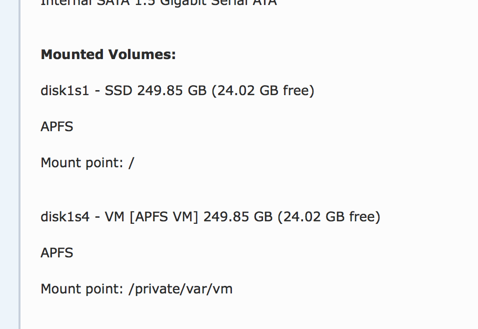

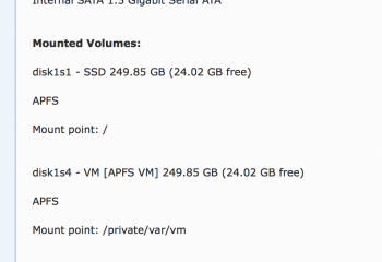

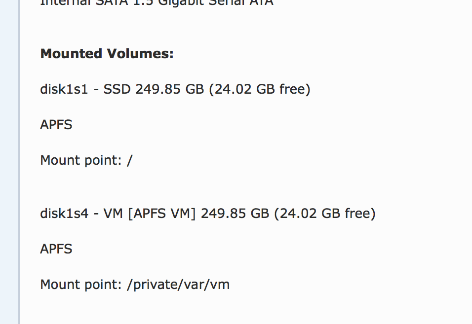

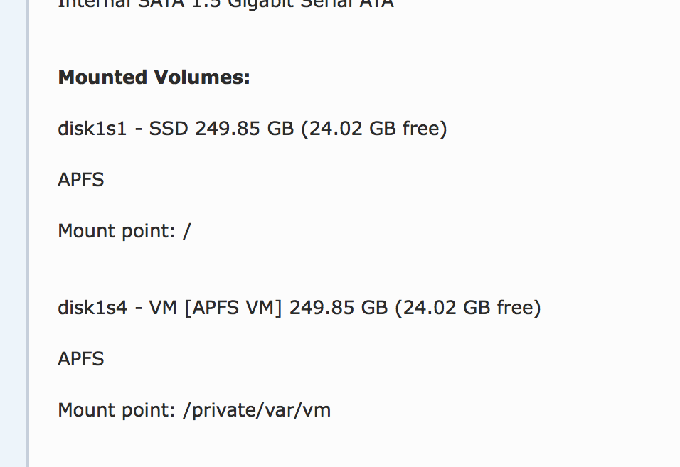

Mounted Volumes:
disk1s1 - SSD 249.85 GB (24.02 GB free)
APFS
Mount point: /
disk1s4 - VM [APFS VM] 249.85 GB (24.02 GB free)
APFS
Mount point: /private/var/vm

Your main drive is too full. Best practice is to keep around 20% free space. That and your TM drive being too small will give problems. Also you should have Trim enabled.
Thank you. I've cleaned as much as I can except for Photos. And I hate to put that on an external drive because I refer to it a lot. Things did get better when I put in the SSD. But now....it's full too My gut tells me to say good-bye to this one since it won't take a bigger SSD.

You have a LOT of third party launch items running there, and any of those may be causing the problem. Try rebooting while holding the shift key to boot into safe mode. That stops all launch and startup items from running. Then test for a bit and see if that fixes things. If it does, then you can start removing those items to find the culprit.
No need to take the cover off to rest the SMC. Intructions here.
That's good news. I'll get that done ASAP! Thanks!
