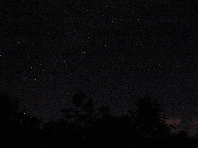

I took some pictures when i was in Tanzania of all the different constellations and I did it with a Canon A40(2.0 MP) they turned out pretty good i left the shutter open to the maximum then set it on a rock facing up, and turn on the auto picture so that i wouldn't shake it when it began taking the picture.
Also a word of caution i don't know where you live but there is this thing called Atmospheric Glow. It happens in metropolitan areas, from street lights, car lights, house lights etc and make it hard to see stars at night.
Example: Pittsburgh i can't see sh** in Delaware by my house sometimes i think i can see every single star in the sky.....speaking of I miss Delaware.
Anyway at least try to take it in an area where there is the least amount of light both on you(so your camera does not think there is light present and adjust to that) and so that you can see the stars better your self.
Here is the picture I took you can see the southern cross in the bottom left
Disclaimer: It was taken on a 2.0 MP Digital Camera not made for this stuff and most important I had no idea what i was doing
