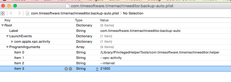

@jbarley and @BrianBaughn please see the above post, i found the file you guys mentioned and also its helper... When i open the main file (see the pic below) i found the #21,600 in the code. the normal time in the OS is 3,600 so it looks like the .plist file was set at 6 hours. I think this is exactly about the time it auto backs up. I will delete them and report back tomorrow to let you know if we have success. thanks again guys!

Sounds like at some point you had TimeMachineEditor installed and running, then deleted the application without first disabling it.
