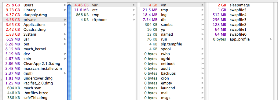

No. Have you ever put the MBP to sleep manually? If so, a 4GB* sleep image gets created. Look at Macintosh HD / Private / var / vm / and see for yourself.
attachment.php
from https://forums.macrumors.com/threads/265475/
Show / Hide hidden files in Mac OS X: http://www.macworld.com/article/51830/2006/07/showallfinder.html
And you don't need to set the timer to "Never", as the MBP will not go to sleep during a TM backup process (hourly) and wait for the backing up to finish. If you don't do anything in between the hours you are away from the MBP and it is still running, there is really nothing to back up.
* If you have 6GB RAM, a 6GB sleepimage gets created, and so on.
