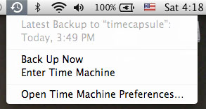

when it isn't backing up it lists the date of the latest backup and this currently says "October 14 2014". So it doesn't look like it is working to me
Yeah, something must be wrong. I have a time capsule. If I click on the Menubar icon, this is what I see…
Have you seen this? You might want to erase the drive and start over. I wouldn't want to keep backing up to a disk I couldn't trust. :) https://support.apple.com/en-us/HT202174
