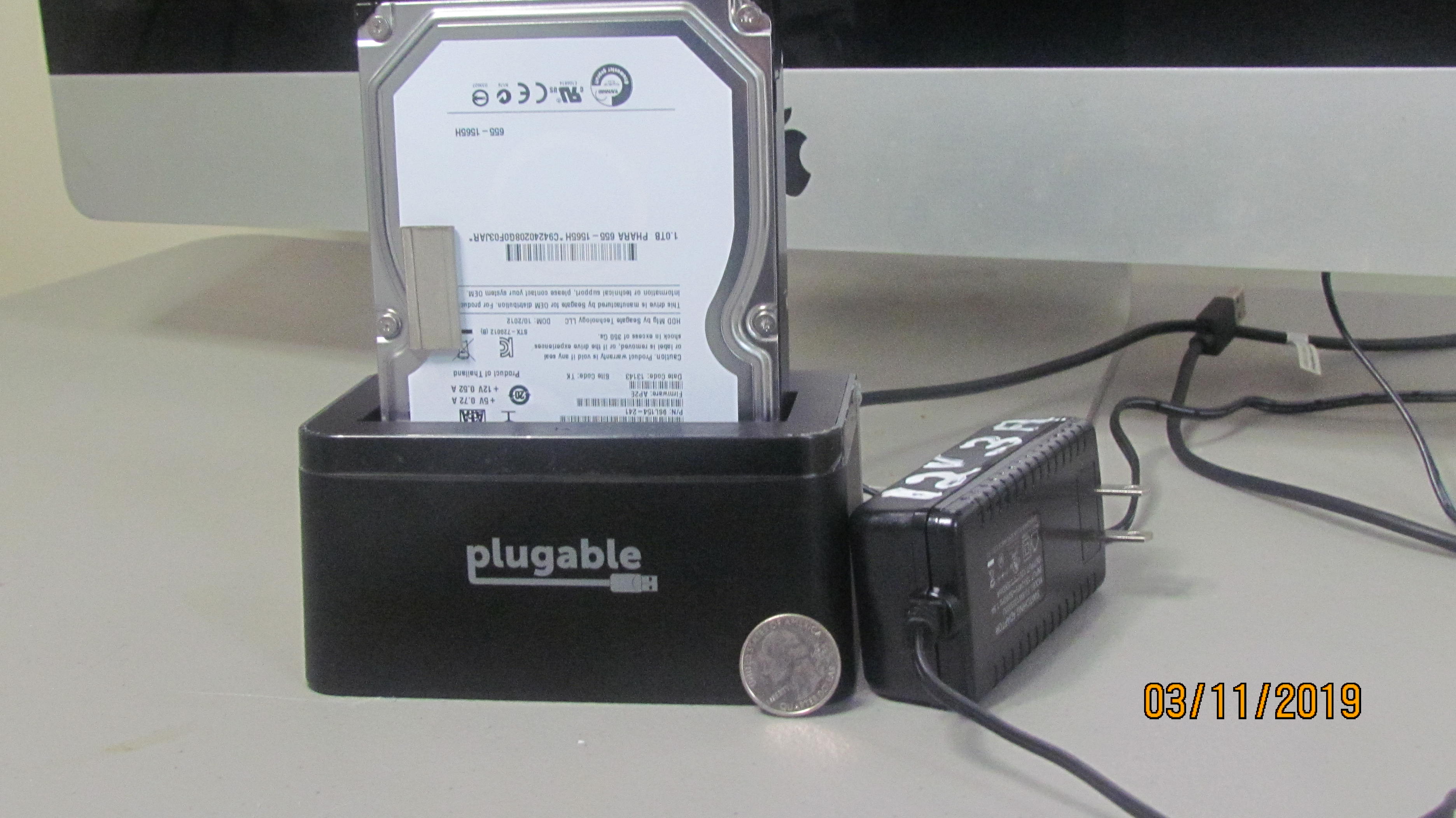

Here's the way I did it, as I anticipate a new computer shortly. This covers most bases and is a low cost solution.
I pulled an almost new Seagate SATA HDD out of my old 09, dead, 27" iMac.
Purchased the "Plugable" Adapter from Amazon $54. Covers 2.5" and 3.5" and ports in C connectors with cables for HDMI and C to C. (sea to shining sea LOL). Runs SATA spinners and SSDs.
Drive I pulled is a Seagate Barracuda 7200-12 1TB. Loaded fast and Runs great as a TM back up.
I will now buy more Barracuda drives from amazon @ $23 each for all my backups. a2 PIX

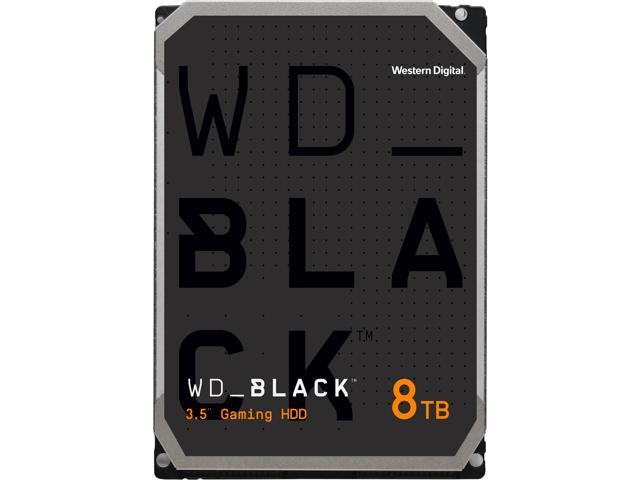

Would there be any real sense in buying a WD Black drive over a WD Red Plus for Time Machine backups? Also, I plan on setting up a 4TB partition for TM (for two systems) and a 4TB partition for data on my 2013 Mac Pro. The enclosure I will be using is a Lacie d2 connected via thunderbolt.
Hard Drives:
Enclosure:
