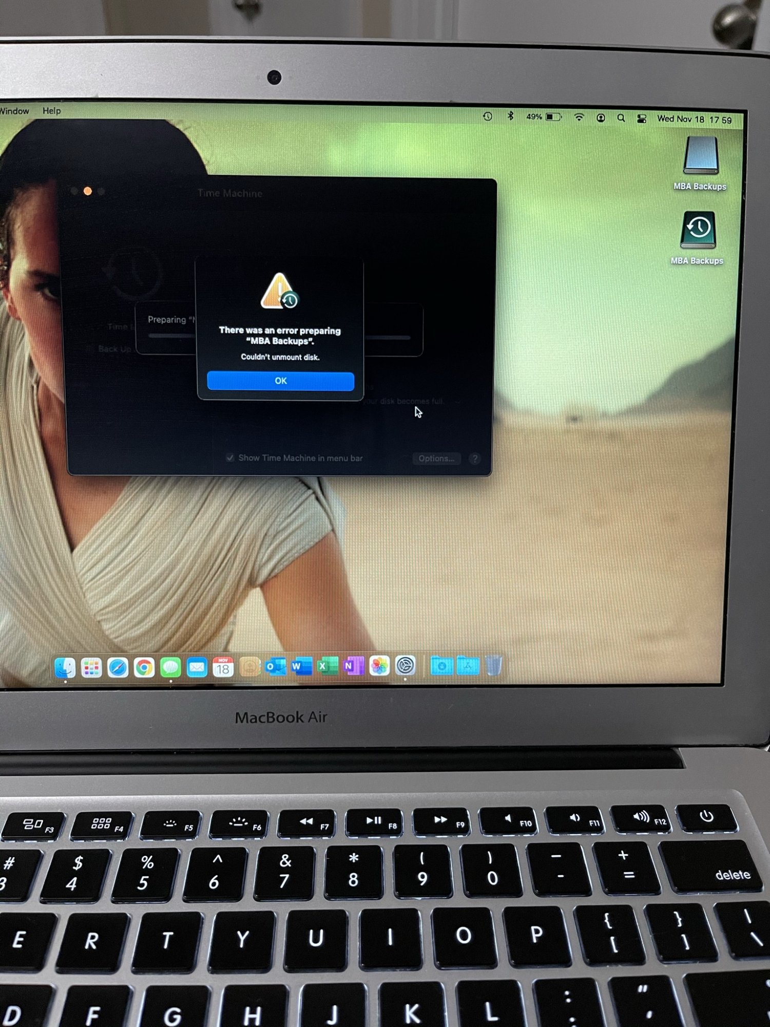

My MBA has been setup as new, with Big Sur as the OS. I am still in the learning phase, and wanted to test Time Machine.
During the setup of Time Machine, I connected a 64GB USB (3.0) flash drive. And, kept getting an error with Time Machine, "Unable to unmount drive"...
Is the above error due to my drive being smaller than the overall drive of the MBA?
Currently, there is NO data on my MBA, merely the OS. I have not even added my Apple ID account to the unit yet. So, no photos, iMessage, etcetera, etcetera.
Weird, no?
Weird, no?

Sorry if I was not clear.
To confirm, during the 'setup' process (first time ever using TM), one has to choose the backup drive of choice.
In doing so, the system configures said drive (does something to it). During said process, is when it fails. Thus, I cannot even 'select' the drive I wish to use for backups.

Merely trying to add ANY flash drive (32GB, and 2, 64GB flash drives - all PNY), to Time Machine.
I select the drive (I can see it on the Mac), and it starts the process to see the drive in Time Machine, then the error pops up, "Couldn't unmount disk". In addition, after this error, I then see TWO of the drives listed on my Desktop.

I formatted the flash drive again, and made sure I used "macOS Extended Journaled"
Once that completed, a message showed in the Notification area, stating, "You can use your new drive for Time Machine. Do you want to set it up...?" (something like that).
Start to process the new drive, and the SAME error as above came up...

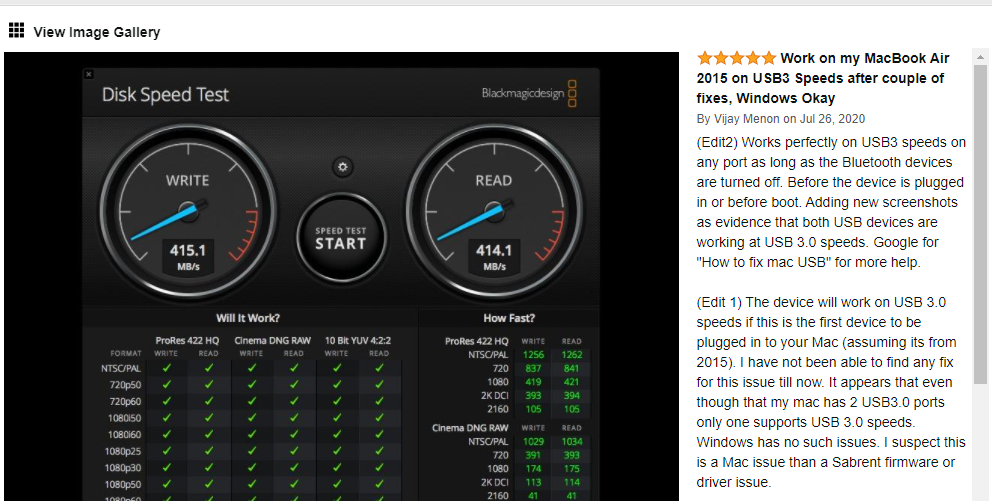

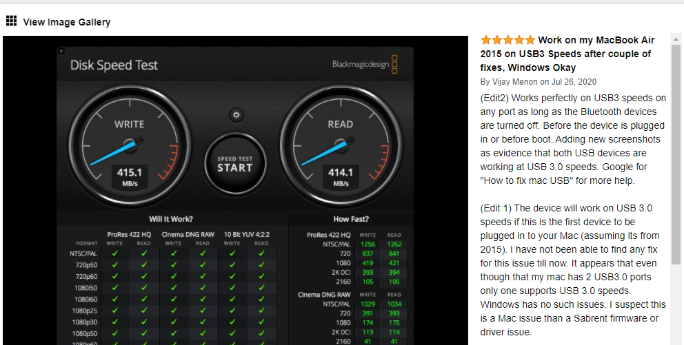

Update:
Today, while searching for a hard drive enclosure, I was reading a review. During the review, the individual had a MBA 2015, and was experiencing issues with the drive and drive speeds via USB. He stated that if you turn off Bluetooth, then connect the drive, the issue and speeds resolved themselves.
So, with that in mind, I turned off Bluetooth, connected my PNY 64GB flash drive. I then formatted it accordingly.
Guess what...?
...the bloody drive is doing a Time Machine backup, as we speak. First one, and it will take 30 minutes.
Guess what...?

This is the link.
Additional Update:
Time Machine's first backup completed! I do wonder if the USB port was not able to draw enough power, with Bluetooth being on. Alas, merely guessing here. Even more so, since the steps I followed are exactly the same as when I started this thread...
This is the link.
Additional Update:
