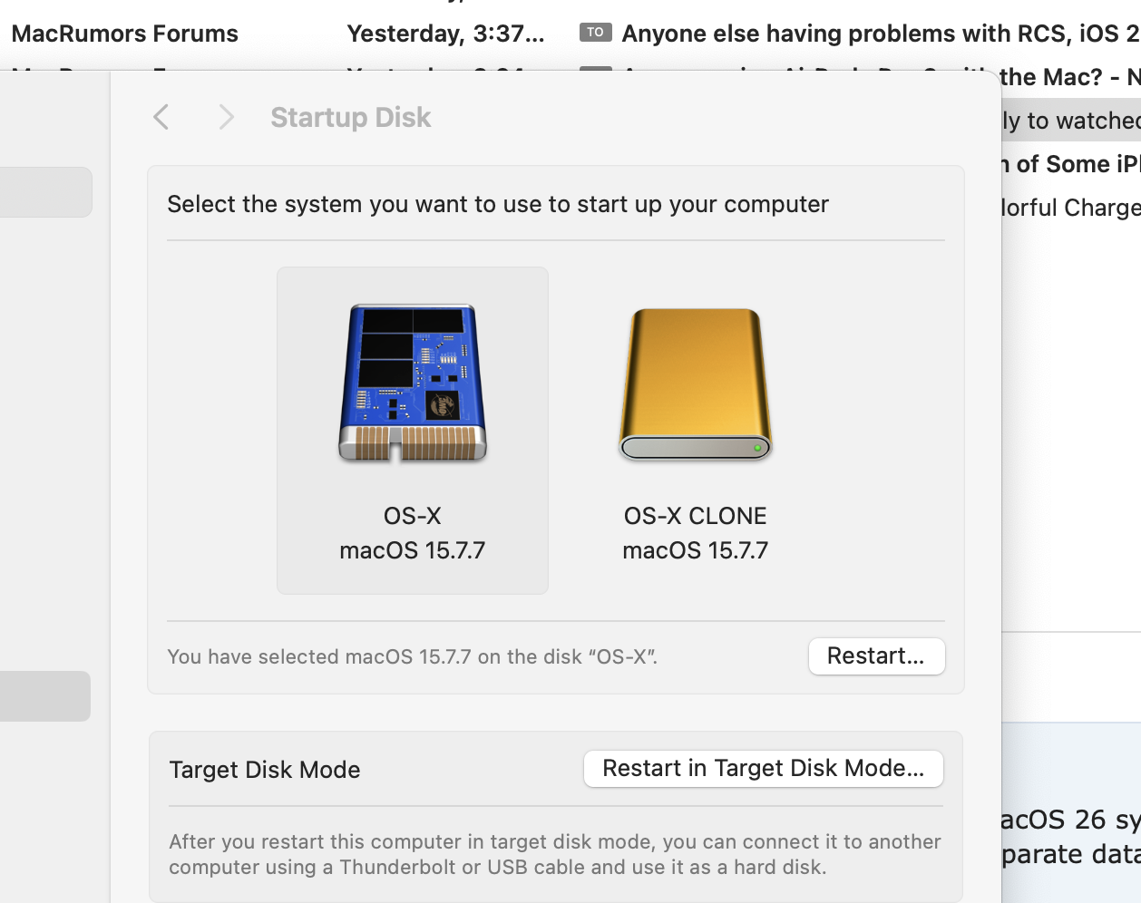

When most refer to macOS "clones", they are referring to "bootable clones". These are a thing of the past. Even CCC doesn't create a "bootable clone" anymore.

CCC still supports bootable clones. (It was broken for a bit with Sequoia, 15.2 I think?)
