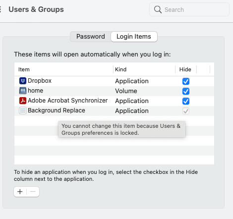

On a M1, Time Machine should not be lagging or causing other apps to lag. What do you have set to run in the background at login?
Not much...
