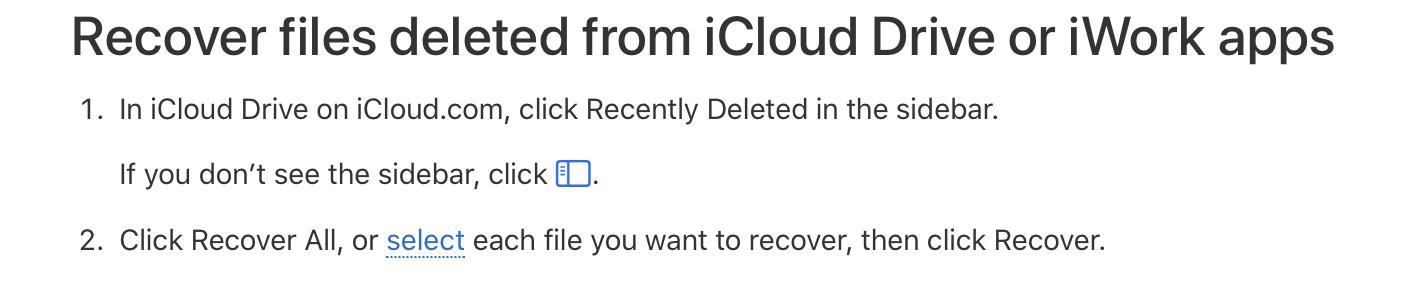

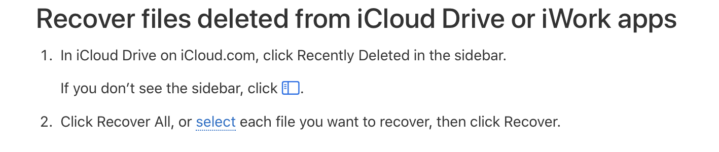

Did you try recover the file on iCloud?

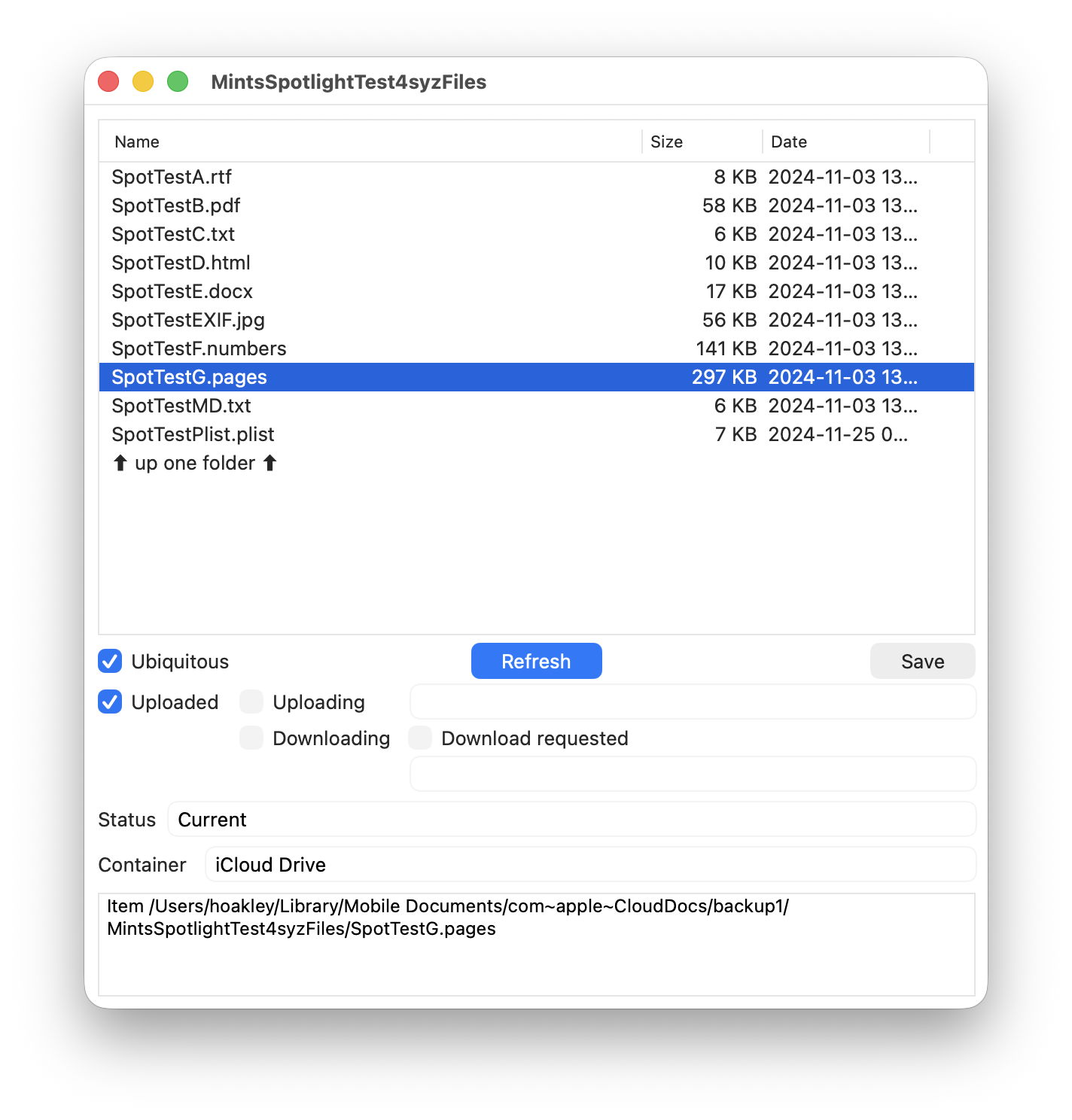

When in Cirrus browser view and you are browsing "com~apple~CloudDocs" (iCloud Drive), at the bottom you should see an entry "up one folder". If you double-click, you get the listing of the parent "folder". Listed will be an entry named "com~apple~Numbers". Your document should be in that "folder" (at least based on your description). Whether it is the latest version of your document, I cannot say.
Aha! I see. The copy of my spreadsheet I found there was the one from 2022, not the one that included some 2024 entries plus all the 2023 entries.

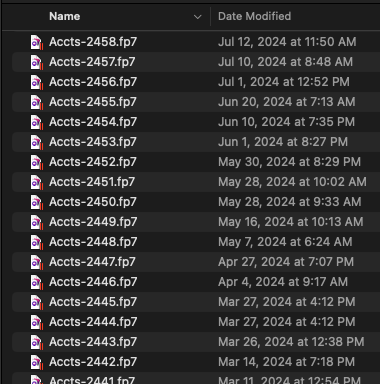

As a simple solution, I suggest "versioning" important user's files that are regularly updated.
This way, if you delete (human error) or lose the file, you can always retrieve the previous one(s) archived.
Create a daily copy of Medicare_UMR payments.numbers and other important files adding the date at the end
Medicare_UMR payments.numbers.${DATE} where DATE=YYYY-MM-DD ; resulting in as many files as archived dates.
This is indeed a very simple and effective solution that I practice religiously! For example, I created a filemaker database named "accts" about 30 years ago to manage all my personal finances. I was using a PowerBook Duo 210 and Mac IIcx as my primary computers at the time! I simply append a number and increment it each time I make ANY change.
Also do this with all my other important files, it's become second nature to me. I have folders named "old" wherever there are important files, and I just drag all these numbered copies there. Every so often, I do housecleaning and delete the older files.
This has really saved my butt more than once. But I also use Time Machine backups to a shared network volume, regular Carbon Copy backups to dedicated external SSD's and Backblaze. I started with an Apple ][ in 1978, got my first Mac in 1985. I still have files going back that far and wouldn't want to lose any of them. 🙂
