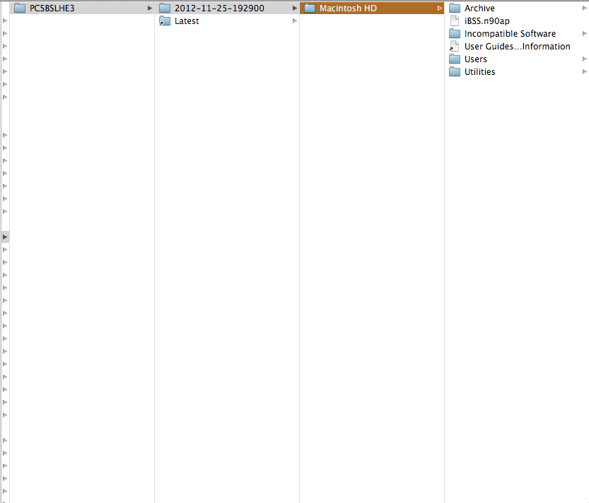

So here I am a month later, with a new MacBook Pro, again. This time, though, I'm having a lot of difficulty restoring all my files. When given the option to restore my files I was only given one, which happened to be the same one from April. So now this computer is where I was 9 months ago.
I can however see the back-up from last month, (and all the files inside it) in a separate file on the external hard drive, but also in the file 'backups.backupdb'. But thats it.
I can't restore from it, or drag it anywhere. Without being presented the message "The operation can’t be completed because it isn’t supported.".
So if anyone could give me a pointer as to how to go about restoring my files I would be very grateful. Thanks in advance.

It sounds like you ended up with two backup files, is this correct? One from last April, one from last month...
If so, you can select one of them using the "tmutil inheritbackup...." terminal command. You might also be interested in the "tmutil associatedisk..." command. These command will allow you to read from a backup file made for another machine, or even continue backing up a new machine to an older machine's backup file. The manpage "man tmutil" will explain how to use these commands. You will need root privilege to execute these commands.

Yes, that's right, I have two back-ups of two different computers. And, of course, I want to restore from the November back up, as opposed to the April one.
I looked into tmutil, and read up on it, along with manpage, and this does seem very promising. Just admittedly, despite researching it, I'm still not to sure how I would go about approaching this in terminal.
Is there anyway you could talk me through this?
