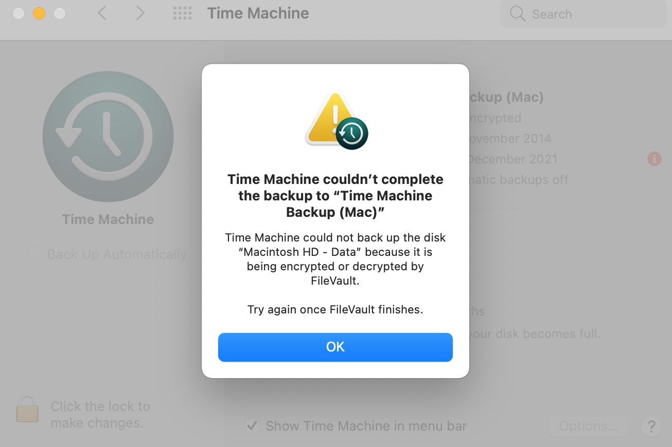

I haven't backed up a few months but since my last backup I activated FileVault which might be now giving some issues. When connecting my external backup disk, no matter how many times I click 'start backup', it will say preparing backup, and then stop.
There is a message that is displayed that suggests it related to the File Vault, but I don't know how to rectify this. File Vault has been implemented for a few months if not longer now, but the message seems to suggest that it hasn't been completed. I'm also not sure whether this is referring to File Vault on the external drive itself, which I'm not sure how to check.

As you have realised, it is saying that TM can't backup because the FileVault encryption (or decryption) process on the system disk has not completed.
You can see the current state and progress of encryption with the Terminal command: diskutil apfs list. What does that say about FileVault and encryption?

Your `diskutil apfs list` looks good with one exception.
There does not seem to be anything with partially encrypted FileVault. But I am concerned about the mount point for the 15GB System volume. That is not normal. Makes me think that your system has an incomplete update - but I don't know for sure. It does make sense that TM will not run with an incomplete update, but the TM error message is then all wrong.
My suggestion (and it is only a suggestion):
1) Copy (drag and drop in Fonder) all important data to another disk, along with /Applications and your ~/Library folder. This is just in case you have a disaster in what follows!
2) Try and remove FileVault and let the decryption complete. Use diskutil apfs list to track the progress until complete.
3) Reinstall macOS without erasing anything.
