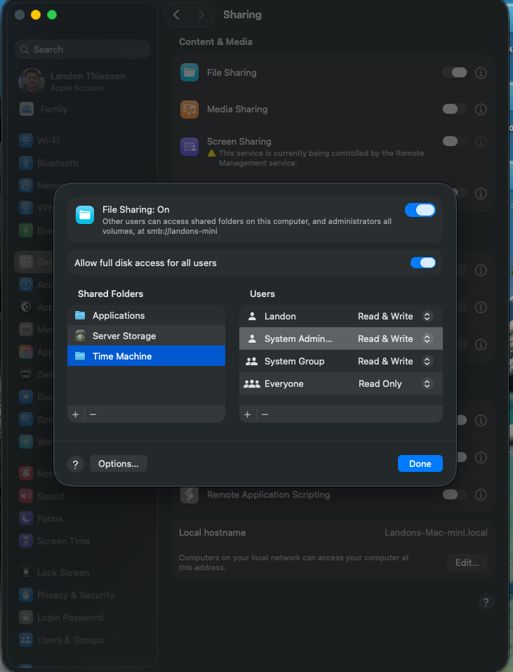

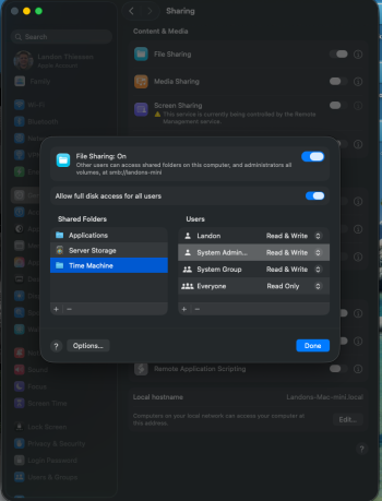

I have the drive partitioned in two, one 22 tb partition for file storage and one 8 tb partition for Time machine. (APFS) The drive is connected to the Mac mini, I have enabled file sharing for the Time Machine partition. Enabled "Share as a Time Machine backup destination", setup my user account and applied the permissions to enclosed items.

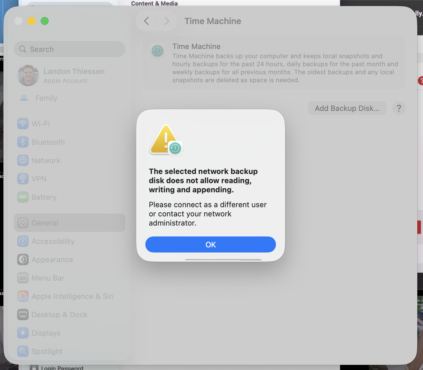

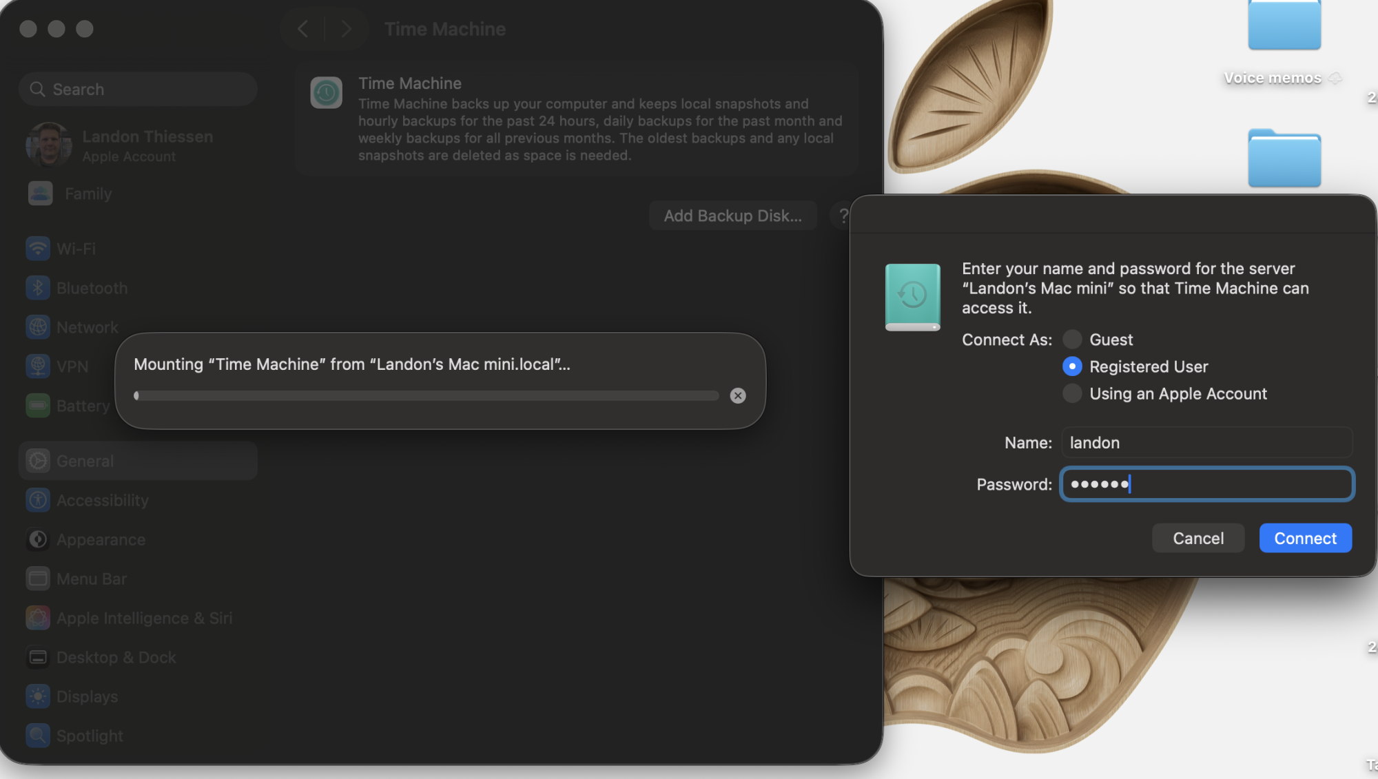

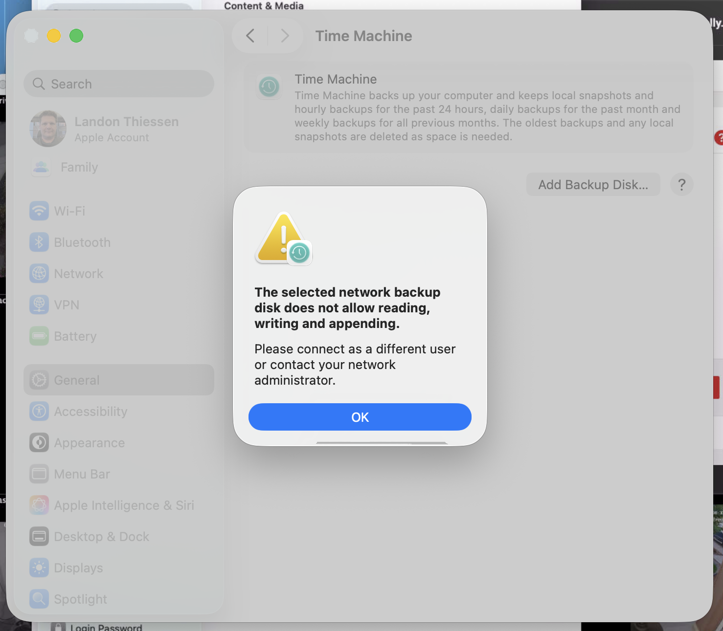

I can get the Mac mini to backup, but when I try and connect the MacBook Pro to the shared Time Machine drive I get an error when logging in to the share (Screen shot attached)

A Time Machine volume is read-only except for the TM dong a backup. So sharing it can only allow reading.
In your 8TB TM partition (APFS container) create a new volume (lets call it NET-TM). In Disk Utility, View > Show All Devices, select the container and add the volume NET-TM. This will share the 8GB space in the APFS container with the local TM volume.
In File Sharing, add NET-TM as a shared folder (in this case a whole volume). Right click, select Advanced Options, enable "share as a TM backup destination". That can now be used by other Macs as a TM destination.

Awesome! Thanks so much for the assistance. This worked great, the MacBook is now backing up also.

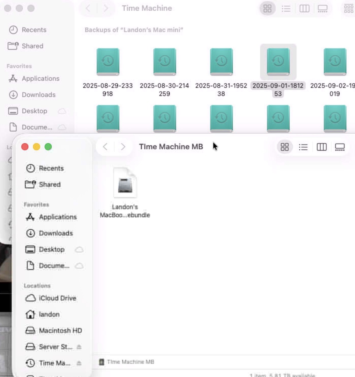

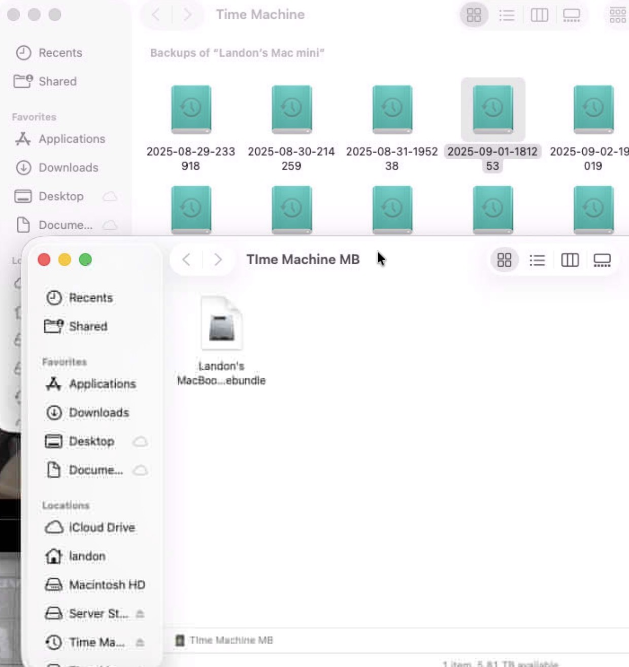

The drive I’m using is connected to the Mac mini. I made the original APFS volume and then created the “NET-TM” volume. But now I have one volume with 100 little files for the Mac mini and one volume with 1 file for the MacBook. What volume should I use for both? Or do I have to split it up like I have it?

Your "Time Machine" volume contains "Backups on Landon's Mac mini". In this case each backup (e.g. "2025-08-29-233918") is an APFS snapshot which contains the folders and files which were on your Mac mini at that backup time. Each snapshot, is a complete representation of the Mac Mini at a specific moment in time. Files which are present in multiple snapshots do not take extra space on the backup volume - this is the magic! of snapshots.
Your "Time Machine MB" volume contains what looks like a single file "Landon's MacBookPro.sparsebundle". It is a sparse bundle contains a complete TM APFS volume inside it - with snapshots for each backup. From the MacBookPro you can see the snapshots.
If you had more MBPs they would each have their own sparse bundle in the "Time Machine MB" volume.
When you use TM to backup to your NAS, TM creates a sparse bundle in the NAS file system. This also contains a complete APFS volume inside it. So backing up to another Mac is just like backing up to a NAS.
