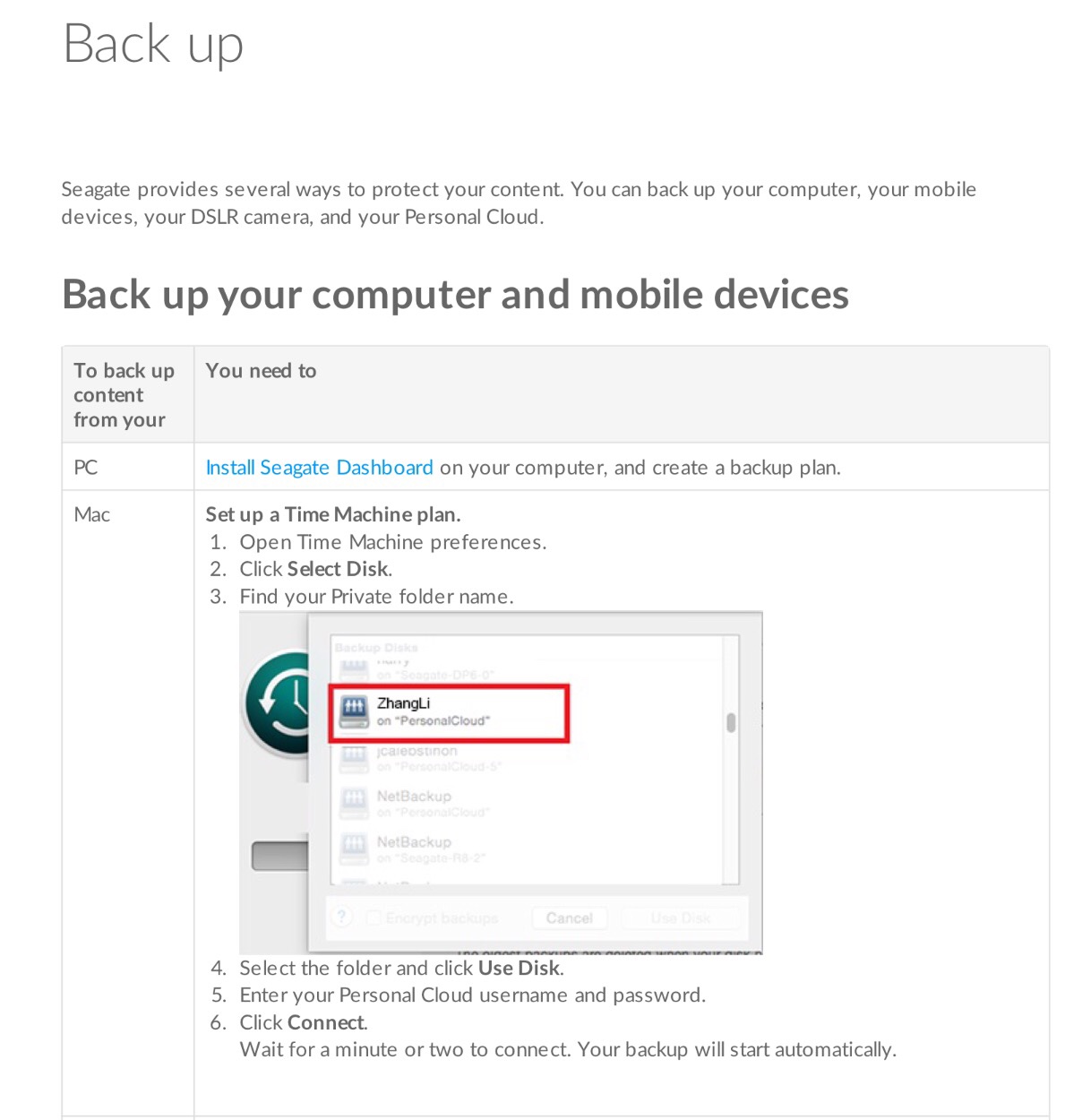

Probably won't know setup options until get it. This is what manual days from downloading it...

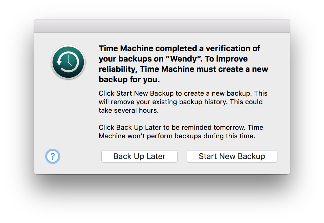

Don't do it. Time Machine is notoriously unreliable with NAS. It's not worth it. It will bork your backup sooner or later, leaving you without reliable backup.
And the WD MyCloud claims to be compatible with Time Machine, and it does work for a few days, then I always get the error message that I attached.
I have the same problem with a Raspberry Pi and the aforementioned Netatalk program (tried it on both Linux and FreeBSD). This is definitely an issue that affects various devices and like stooovie I suspect that this is a bug in Time Machine. Caveat emptor.

Didn't get any relevant support answer from WD. They just shake their head and tell me to re-create the backup. As if I didn't know that already.
Unreliable backup = no backup at all (of course, no backup is ever completely reliable).

Whom are you going to email? The problem lies in the Time Machine software. It doesn't matter which third-party hardware you use. If your Time Machine backup is corrupted, you'll lose everything on it. In addition, Time Machine is really, really, really slow over network. It took my Raspberry Pi (connected with Ethernet via my Wi-Fi network) 15 hours to make a backup of a 120 GB SSD. Even if it is much quicker over Ethernet alone, it will take forever to back up a 2 TB disk. Also, Time Machine works best when your backup disk is 2–3 the size of your main disk.
See also this bug report: http://openradar.appspot.com/radar?id=5220285250797568. Apple said that they fixed the issue in Mavericks 10.9.5, but it has since resurfaced in Yosemite and is still open.

Just don't backup with Time Machine via network. It just doesn't work reliably. Forget it. Not worth it. Slow and unreliable is the opposite from what you want in incremental backup.
Encountered the Time Machine error today after using it with my Synology NAS for about three months. It says it needs to completely start over which is not something I want to do on a regular basis.
