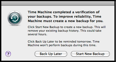

I've been getting this "error" message:
It first happened a few months ago, and I did the new backup. It took forever, and kind of screwed up some stuff. Now I'm getting the message again. I didn't some searches, and it seems that this is an error message. Is there a fix for it?
Also --I'm backing up to a WD external drive on my network. My Mac's Disk Utilities doesn't see the drive. Is this odd? Is there any way I can run a utility on the networked hard drive?
How is the WD drive setup on the network? My guess is you are using an unsupported Time Machine configuration that is resulting in data corruption and these errors.

I agree with this comment too. Time Machine can work on a non-capsule networked drive but the process is not totally reliable. It may work for awhile and stop working, not work at all, or work perfectly. Might try a different external drive to see if that keeps this from happening.

Your backups are getting corrupted because you are backing up to a USB drive attached to an Airport Extreme, and that is not supported by Apple (although one would think ti would be). The new tower shaped Extreme supports this, but the older flat ones do not.

That is the thing... they just seem to work fine sometimes then stop working. It has nothing to do with your drive, it is the Airport Extreme that does not support this. You can try again, but you may have the same trouble. I would not trust my backup data to this.
The only "Apple supported" solution is either a Time Capsule or another Mac running OS X Server edition, or a drive directly attached to the computer.
It is even mentioned in the online help for your Mac.
