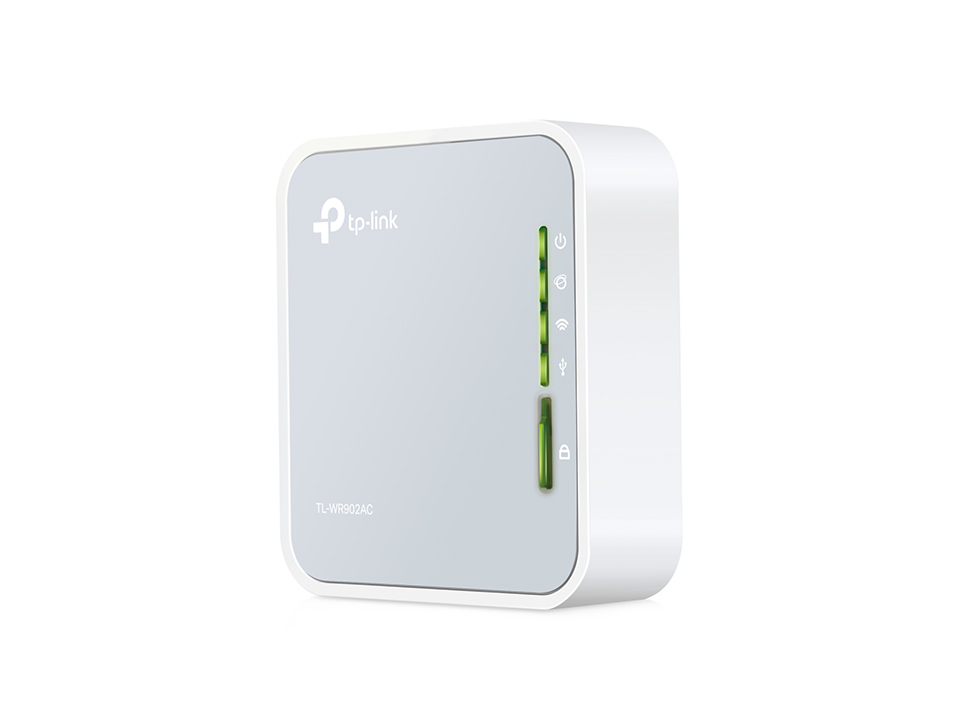

Just found this... it seems that using this is "client mode" (the fourth mode described at the link) is exactly what I need, though the ethernet is only 10/100...
