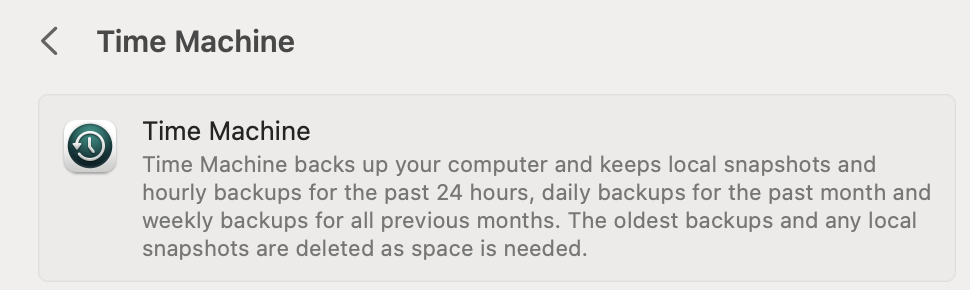

1. It does.
2. It does.
@kitKAC, appreciated.
The question therefore is why did I get a message that my Time Machine drive was full (and further backups could to be made)?
